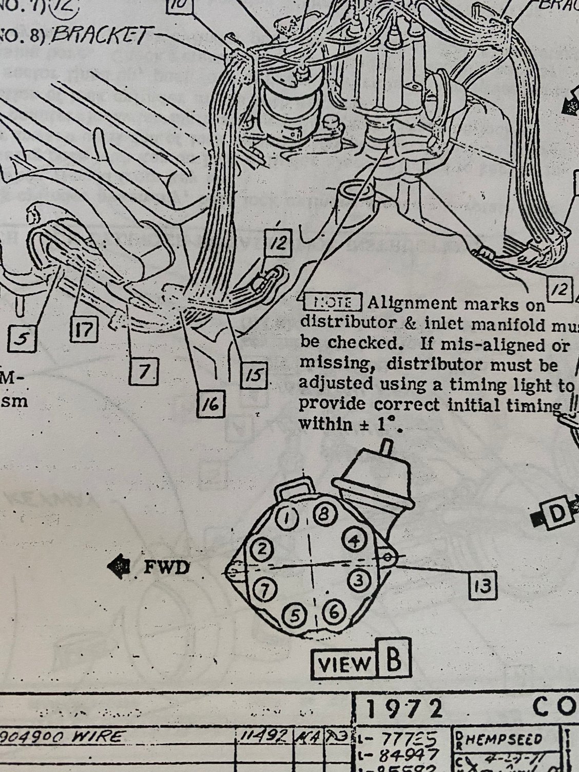

Thanks for all of the tips so far. The information has all been valuable and gives me a better overall understanding of setting the timing. I have a small setback in that the tach cable is broken due to being pinched off on the firewall. It looks like I have the distributor in the wrong location. See the pic of the orientation in the aim manual. Is this what everyone is using for 1972 base? If so I’m 2 positions off.

That diagram shows the correct orientation for all Corvettes 68 to 74. Not sure about later HEI using electronic tach.

Do you have your wires set up the way the diagram looks, #1 cylinder is to the left of cap window when looking from above, and does the vacuum advance point to the back of the passenger side valve cover?
If everything is set that way you should have no problem with the tach cable.

you put the distributor body wherever the tach cable fits best. then you decide where you want #1 and set the rotor up in that position as you install the distributor, having the engine at #1firing TDC. NOT #1 other TDC which is 6 firing. generally #1 and 2 are up front to shorten the distance the longest plug wires have to go.
