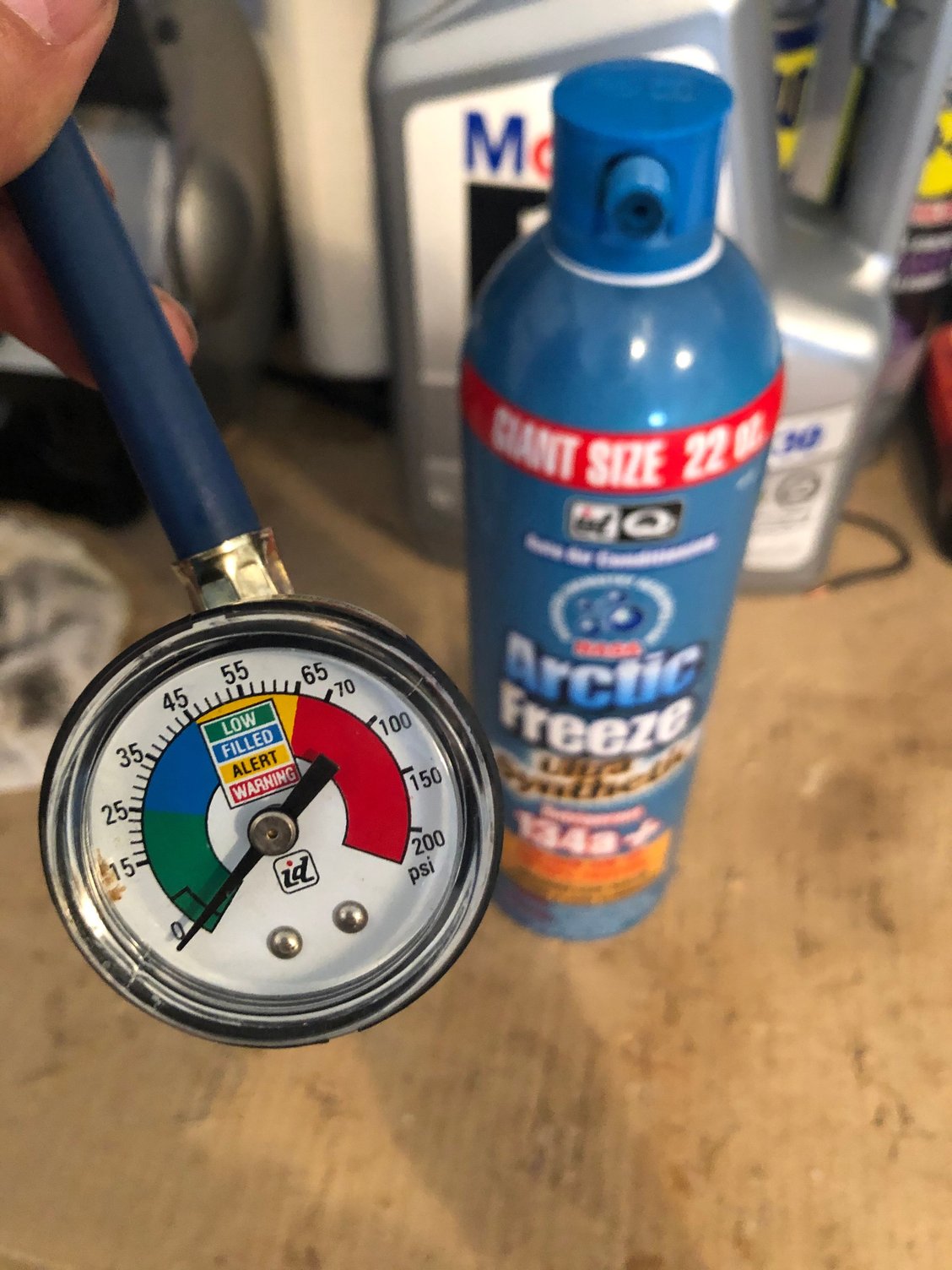

Doesn't seem right at all, and backwards. Static pressure as mentioned in post three depending on air temp should be lot higher. Zero pressure is empty system when static and low or going into a vacuum when running. Places like autozone lend equipment out such as AC gauges, leak tester, vacuum pumps, etc.
Picture of your gauge being used?

Just the cheap gauge that came with the refrigerant.

Old Jul 4, 2020 | 02:52 PM
ffarina's Avatar
ffarina
Joined: Aug 2009
Posts: 191
This is the reading now on the low side - with engine off.

how much refrigerant have you put into the system?
Neal
Old Jul 4, 2020 | 03:18 PM
ffarina's Avatar
ffarina
Joined: Aug 2009
Posts: 191
I used this can but it would not take it all.
