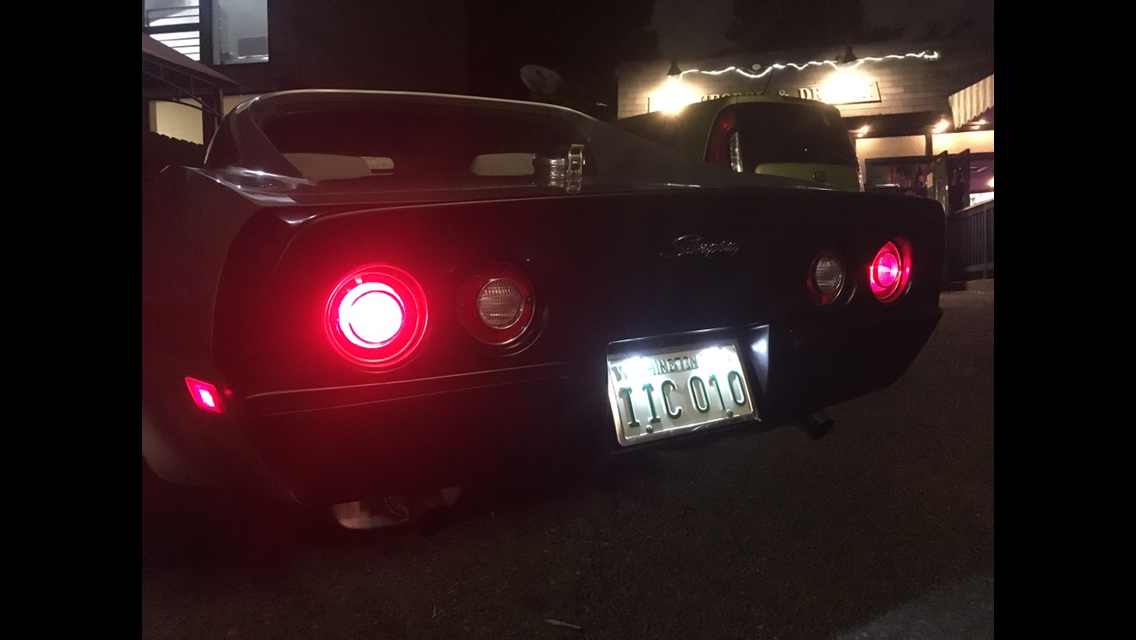

I installed LED's rear lamps from Corvette Central. it comes as a complete kit that replaces the b/up lamp into a stop lamp. as for b/up lamps I went to Zip Corvette and ordered their license plate b/up set which is not installed in this pic

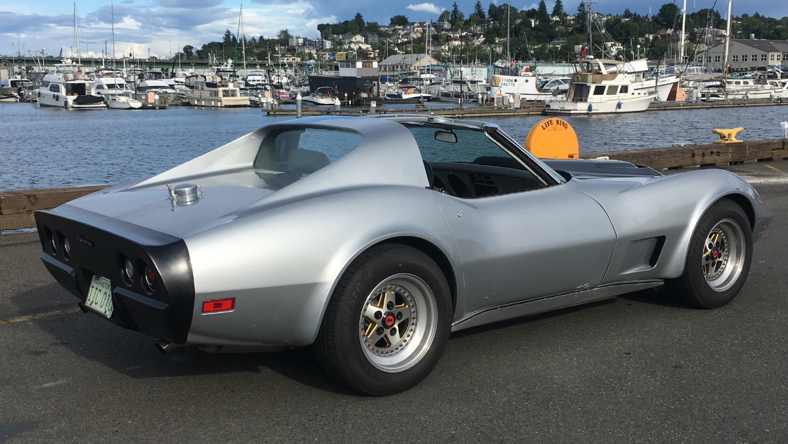

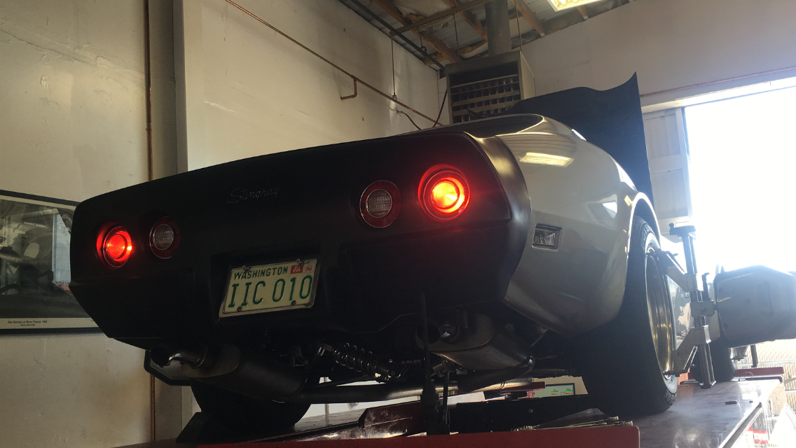

Yes it can be done. I made a jig and very carefully split them on the bandsaw. Started with new oem units. This is my 75 with a 68-72 tail.
The stockers are very bright with healthy bulb holder sockets and proper grounds. led tails look funny to me on a C3.

It’s a fiberglass cap that bolts onto a 74-82 to emulate the chrome bumper cars. In my case “no bumper” as I chose not to install the pretend chrome bumperettes that come with the kit.
Highly controversial as exactly zero of the original hidden impact safety equipment is retained. Some folks don’t care for the way the part aligns with the lines of the car.
You have to source earlier 2-piece tail lights or split the ones you have. If you care about a license plate light you make your own. I used motorcycle style bolts with integrated lights.
For my hacked up 75 I think it fits. I might even paint it someday.
