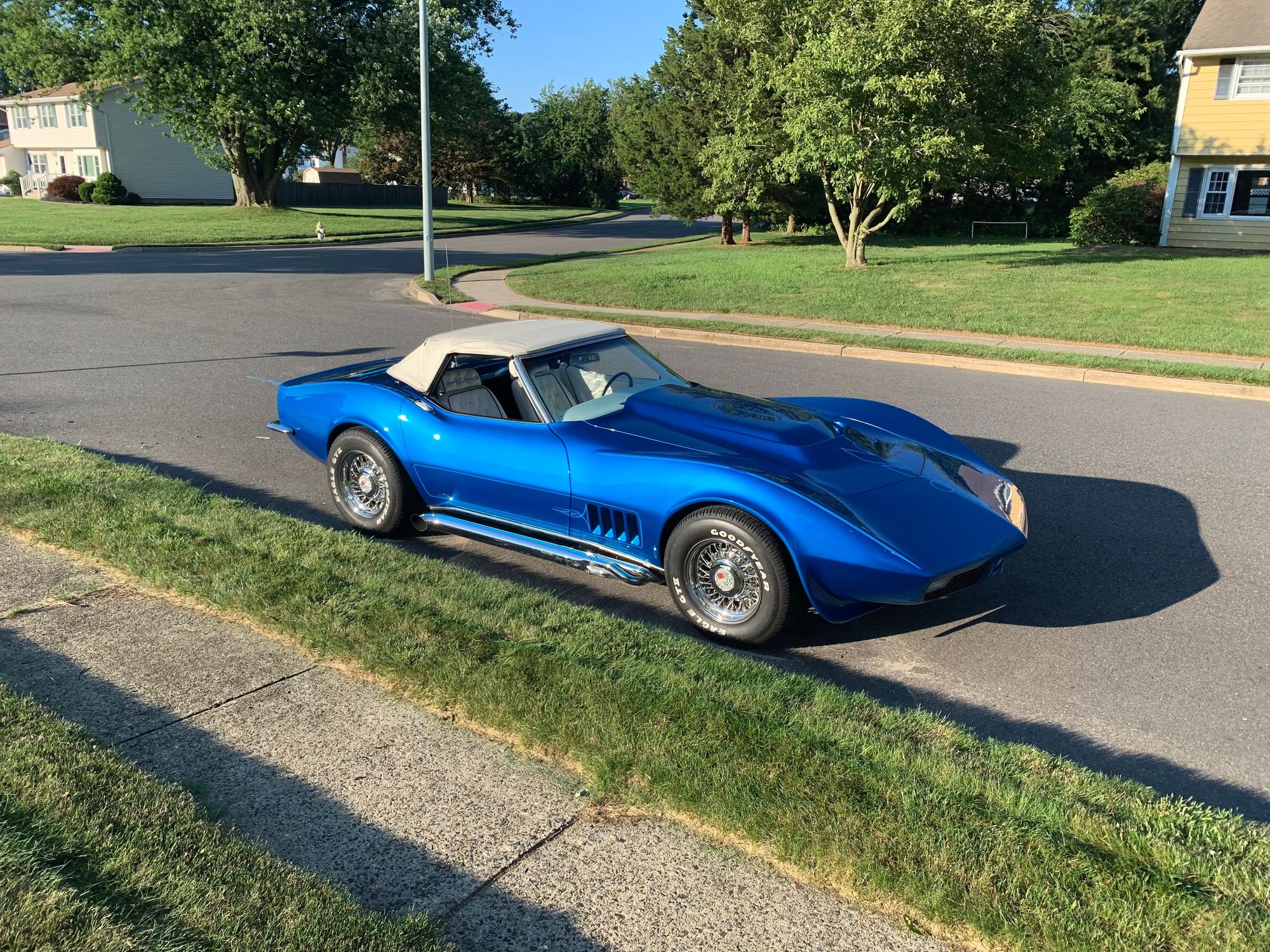

Originally Posted by monstr
Really nice C3!!
