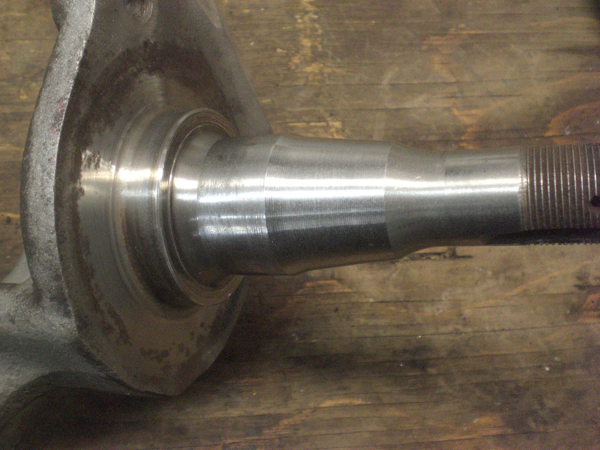

Here a some pics of my left front spindle.
Spindle looks OK here

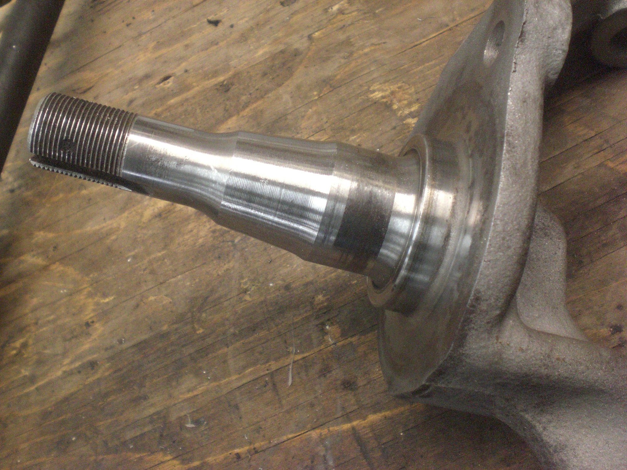

While surface is smooth, this section on the inner end has some discoloration.
Help educate this novice as to how much spindle wear is acceptable...

Hi, do you have a micrometer or vernier you can measure the diameter with? If not a rough guide would be to see if your fingernail gets caught on any ridging at the edge of the discoloration, if yes the spindle will need some attention. There are a number of products made by Loctite and others that could be used to mount the bearing to prevent the inside race from spinning on the spindle. JMPO.
I believe spindles are hard to get, many second hand ones show ovaling of the taper holes that the ball joints connect into caused I believe by impacts such as hitting a curb or big pothole.

Try fitting a bearing on it. Does it go on snug? If not, scrap it.

You may also raise the steel in worn band by using a good centerpunch and hammer; striking a few dozen equidistant indentions.
The metal around the indention is raised. Afterward, you may need to reduce that a bit using a strip of Emery cloth. Don't let that dust get on your bearing.
