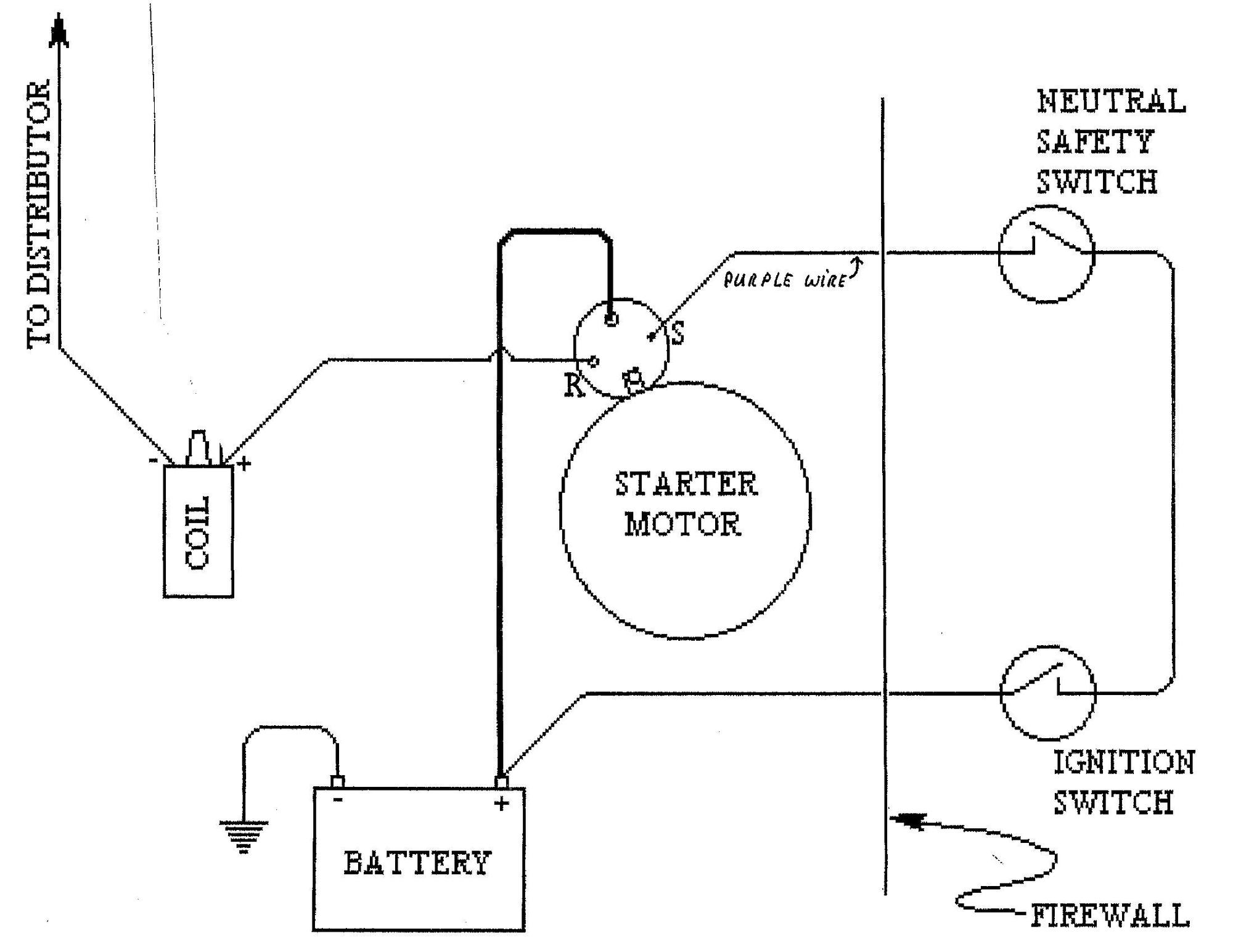

Originally Posted by talc
While the carb was being rebuilt I swapped out the original starter with a high torque version. The vet has points so I put the coil wire to the 'S' post of the starter with a diode. Unfortunately, she won't start.
The PURPLE wire connects to the 'S' terminal of the solenoid (small terminal closest to the block).
Your mini starter has no small terminal for the yellow wire so leave it off for now.

sounds like he has a new type starter with no R terminal.
