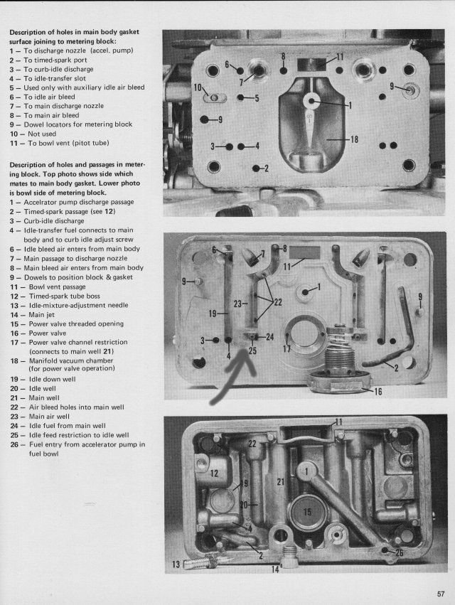

You need to tune the "Idle Feed Restriction". This part of the carb feeds fuel to the idle circuit as well as the transfer slots. When at cruise, (around 2K rpm or below) you are NOT feeding fuel from the main jets, so jet changes do nothing. Mostly using the transfer slots.
I have a R4779 750 DP, Holley. With no idle feed restrictions in place, at cruise as you stated, I get black spark plugs. With .021" restrictors in the idle feed, I get white plugs at cruise, and lean ping at times.
Currently I'm running .018 restrictors and now have light tan color plugs. Seems to be the correct restrictions for my particular carb.
With all the experimenting with restrictors, fuel mileage didn't seem to change that much.
What did change drastically, was with the restrictors in place the engine did not "load up" like it did without the restrictors. "Load up" = after a long cruise, a few WOT passes thru the gears was required to clean out the crap.
Idle feed restrictor # 25
thanks, there are some aftermarket metering blocks on the market, can you recommend some?
ive seen some of them has jets for emulsion, What is that for ?
Do I get same result at cruising with bigger idle air bleeds (on a carb with changable bleeds) vs restrict IFR on a carb without changable air bleeds?

Not sure why you are asking about aftermarket metering blocks ? The ones that came with the carb are likely the best for your carb. You just need to do some tuning.
I did increase my Idle air bleeds in the beginning, however it showed no improvement in the rich cruise condition.
I then went for the fuel restriction which gave me the results I wanted.
I'm no expert on air bleeds, yes i would like to have changeable air bleeds, just to do some experimenting. However what I have now works great, so am leaving the air bleeds alone.
I would do some testing with your idle feed circuit.
It's quite simple, just use a piece of non corrosive wire and place it in the idle feed hole. About 1/2 to 5/8" long. Just use a piece long enough to bottom out in the hole and is not protruding past the face of the metering block.
I think my .018 wires was from a leg of a transistor. Source can be wires from resisters, leds, etc.
You should have a digital Vernier caliper to keep track of different size wires (restrictors)
There is metering blocks with changable IFR jets, so you dont have to use wires....
That would be great, would save time looking for different diameter wires.

You are correct in stating that you can fine-tune the AFR at light throttle cruise by using a restrictor wire in the idle feed restrictor orifice. What I have found works perfectly in many cases is a simple staple out of an office stapler: Pop 2 staples out of a stapler and straighten out one of the bends so you have an "L" shaped piece of wire. Stick the short leg of the "L" into the IFR, and sandwich the long leg under the metering block gasket for retention. This will quite often get the cruise mixture up from mid-12's into the mid-14's, and it will also make your idle mixture screws more finely tuneable (will change idle mixture screw settings from 3/4 turn out to 2 turns out, as an example).
