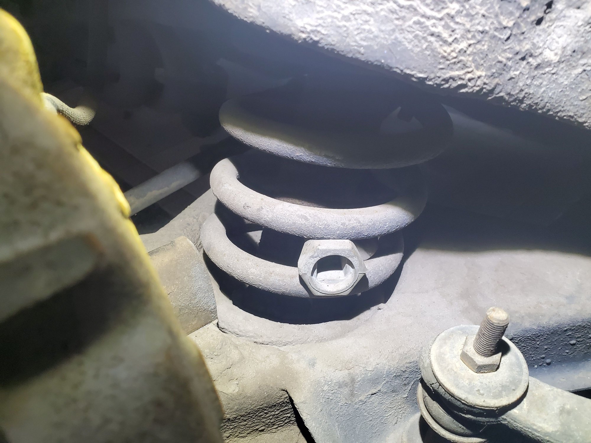

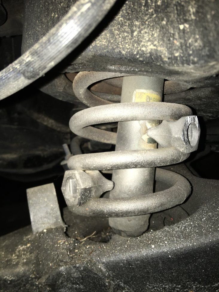

Does anyone know what found between the front passenger spring (picture 37)?
35
36
37
Yeah, I found a few of those too. Bubba decided to level out the car using those. I did the right thing: tossed and replaced the coil springs.

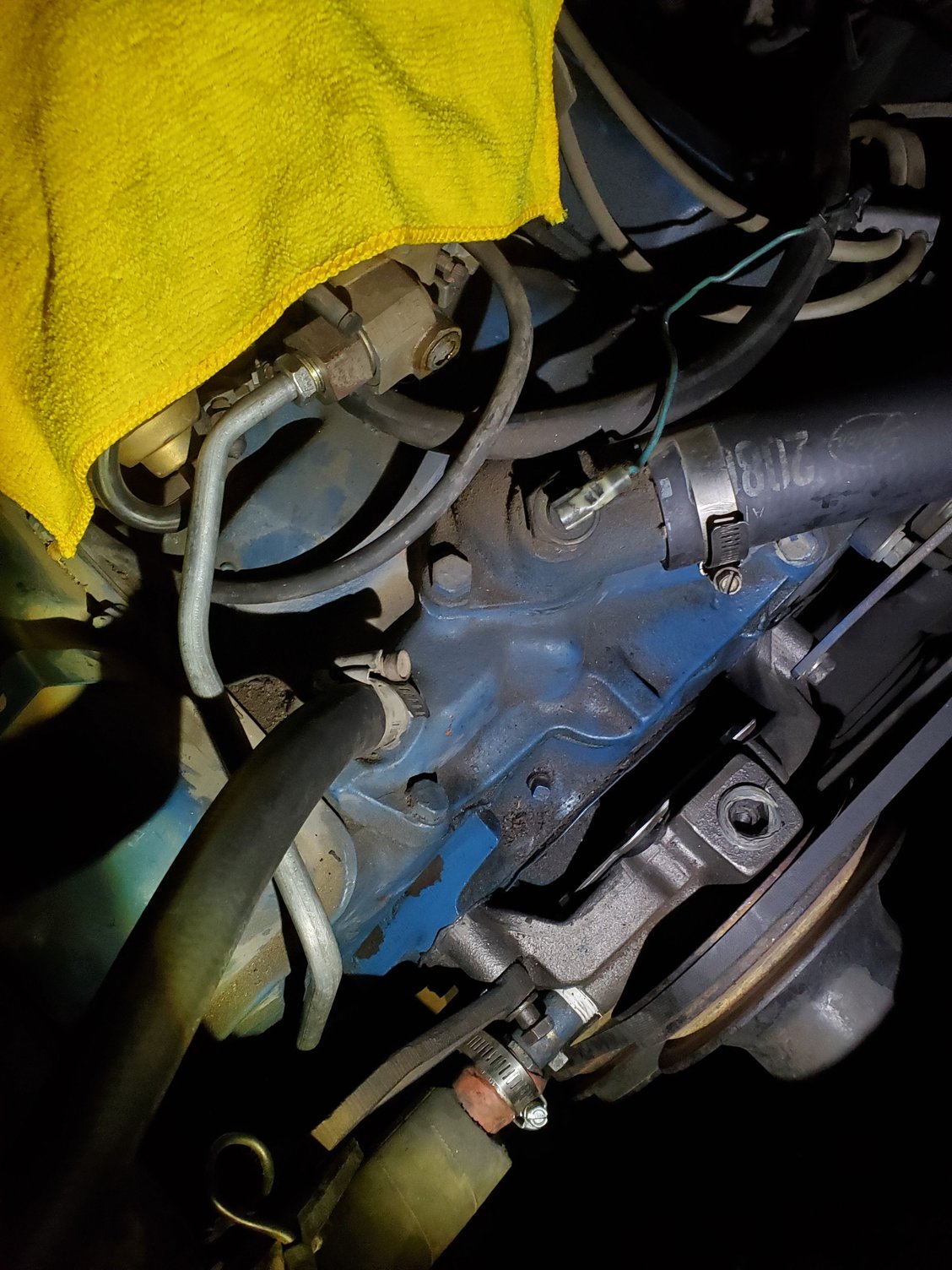

I haven't had too much time, but I did want to post an update and maybe it can help out others. About two weeks ago, I replaced the fuel pump, rubber hoses that go to the fuel pump, and the rubber line to carb w/ a correct steel line. I also replaced the fuel filter in the carb (the old one was toast). Long story short, no more fuel smell (when the car is off at least), and so now I'm able to store the car in my garage .
With an AC car, it didn't seem possible to remove the pump from the top. The best bet was to go through wheel well with very long extension. I replaced both the fuel pump gasket and the adapter plate gasket. To help remove the old gaskets, I used a razor blade with a plastic handle ($2 from harbor freight, being careful not to scratch the metal surfaces). Cleaning the engine block surface was a pain going through the wheel well. I tried using a plastic gasket removal tool but it wasn't strong enough to remove the 30+ year stubborn gaskets.
To hold up the pushrod, I used red-n-tacky heavy grease, which worked pretty well (it would start to slide down after a few minutes or so). I did not need to turn the engine to adjust it to TDC. I also used the trick of using a longer bolt in the bottom right of the engine block to hold the pushrod in place, although the bolt was tough to get to. For the gasket surface, I used a small amount of red RTV to help make a better seal (spread it thinly on the metal surfaces with my finger). When reattaching the fuel pump to the block, I had a half inch gap or so, but it went away as I tightened the pump bolts (making sure to alternate). To reattach the hoses, I used a clean rag with a small spray of WD-40 to lube up their insides so they could more easily slide onto the metal lines. I used gas line PTFE sealing tape from Home Depot on the brass elbow to help seal the connection to the fuel pump. To attach the metal line, I slipped it in through the top (took some finesse), and lightly tightened the fuel pump side then carb side, then tightened both. Fired it up, no leaks after a few minutes, and drove it inside. Smelled like fuel for a bit, but once the car cooled, it was ok, and now it does not smell like fuel at all, thanks everyone for the help! See below pic for new fuel pump and new steel line to carb.

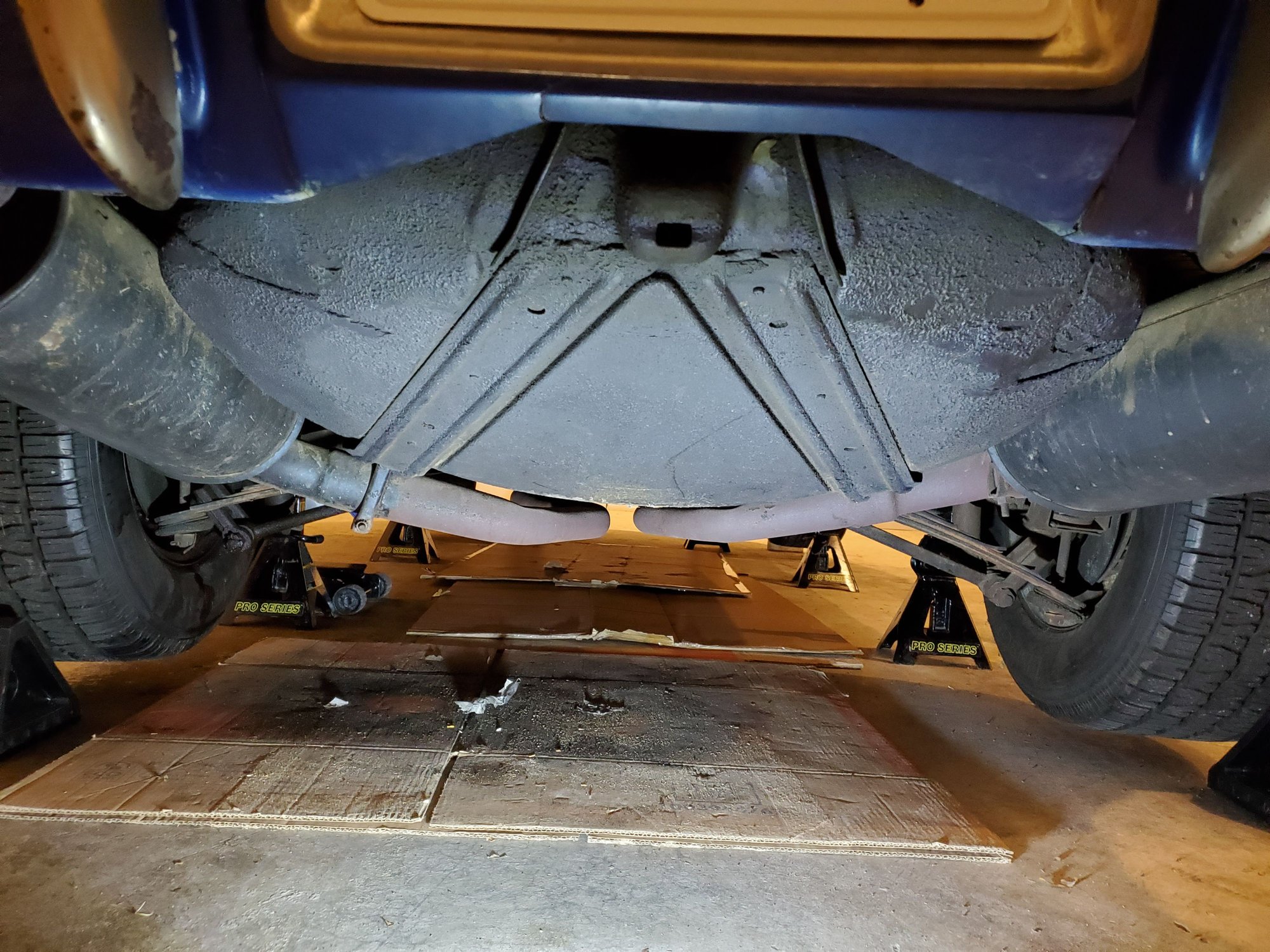

An update finally! Over the holiday break, I've had some time to read up on the brake system and will be taking apart the calipers to see if they are sleeved and if I can rebuild them. More updates to come this weekend.

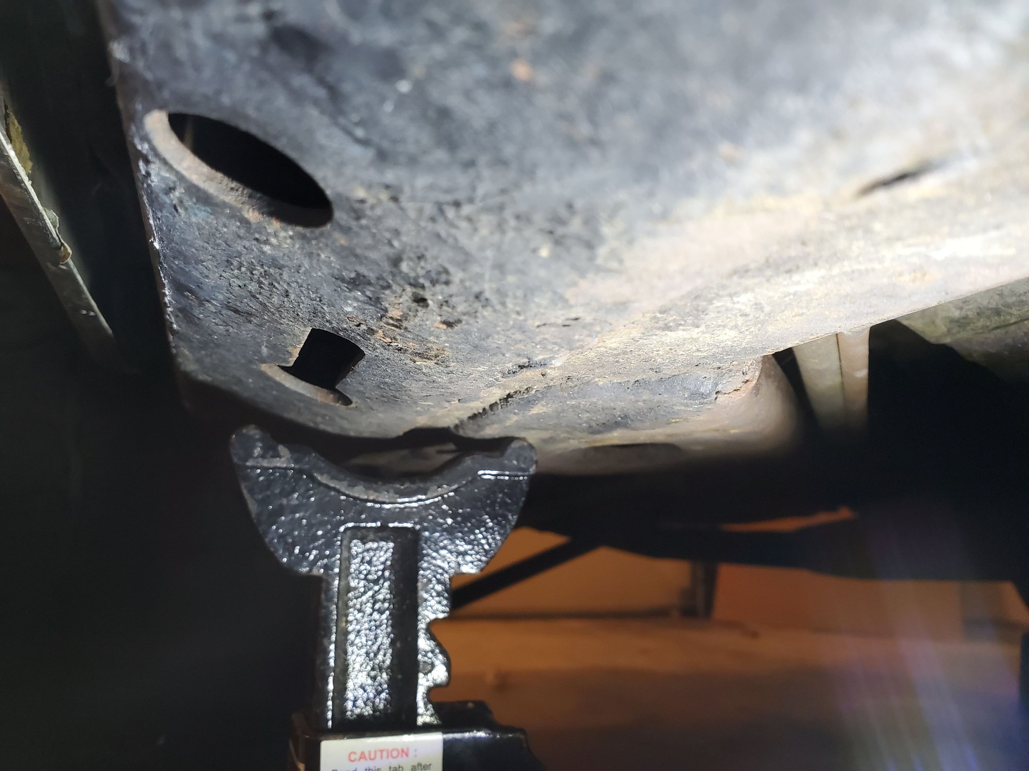

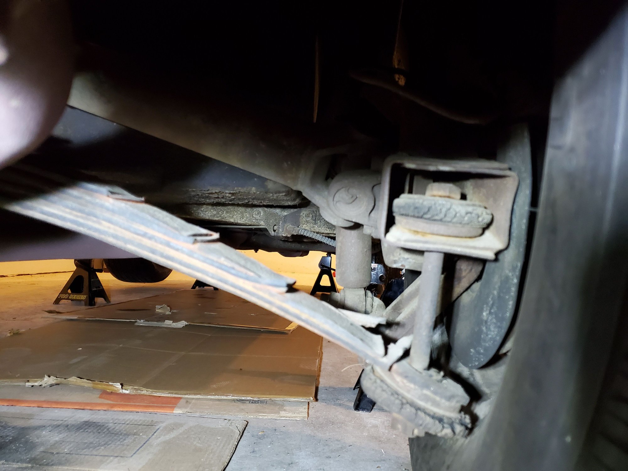

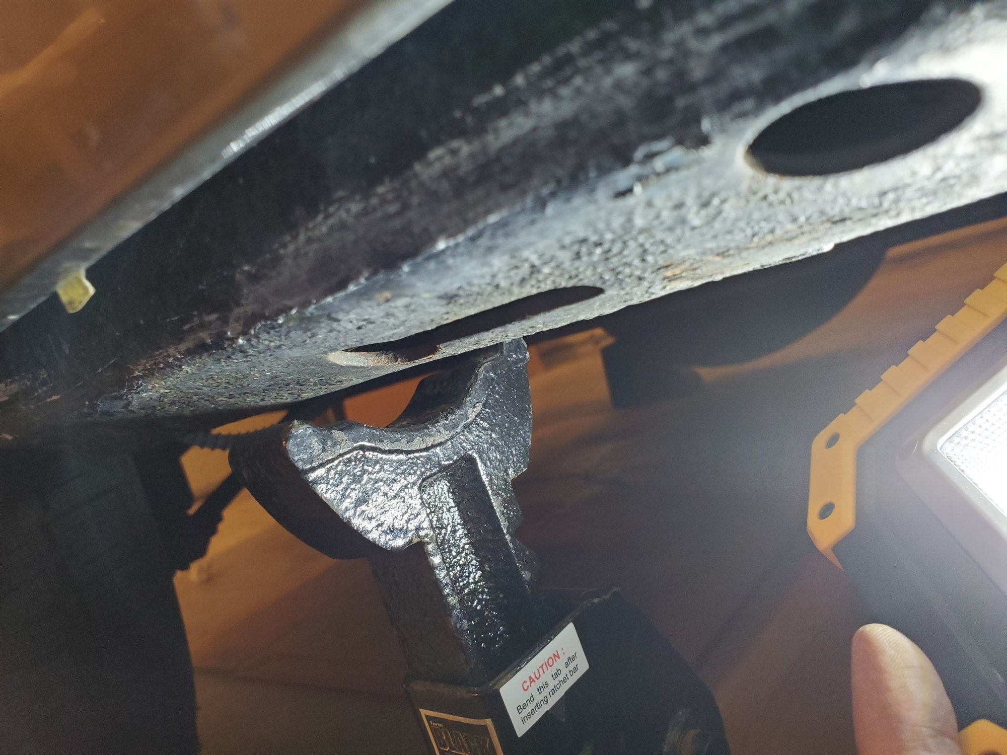

In the meantime, I've lifted the car entirely on jack stands for the first time, and wanted to get some of your opinions on two things. The jacks are placed where the Service Manual recommends (side frame in front of rear tires and side frame behind front tires):
  1. The front two jack stands are making full contact with the frame. However, the rear two jack stands are partially contacting the frame (see image 40 and 41). I wonder if this is common. The car seems very stable, I tried rocking it but it would not budge. Does anyone have any up close pictures of how their jack stands contact the frame? I don't want to push them inwards more because then they will be on top of the welded gusset plates off of the frame (you can see in image 40 the jack stand is on the welded gusset plate but also in the same z-stack as the frame).
  2. Looking at the car from the rear, the right side of the leaf spring seems to droop significantly more than the left side (see image 42 and 43). Note I am on a level surface and jack stands are all the same height. What could be causing this? I haven't read about the suspension system yet.
  1. 40 - rear jack stand
    41 - rear jack stand different angle
    42 - look at leaf spring
    43

Those frame rails are not even..normal crappy alignment of seam...they are touching...that is why sometimes a jack pad helps grip and not one small point of contact...
looks like rear bushings shot...verify bolt length to nut on spring...and bet strut bushings gone
yes i would probably move stands inward for best contact
do close inspection of spring, bolts etc..
right rear caliper appears to or has been leaking

If you plan to keep it up on the stands for more than a couple of days, you should place two jack stands under the front frame rails to support the weight of the engine.
When ever I use jack stands I will place 12” X 12” X 3/4” plywood squares under each stand.
The base of the stands will bite into the plywood and give the stands better weight distribution against the concrete and not allow movement of the stands.
You will find that the stands supporting more weight will sink into the plywood deeper and allow the frame rails to rest on top of the other stands where you are seeing slight gaps and so supporting the weight more evenly.

Jack pads are nicer to the frame. Or fold-up a rag several times on top of the jack stand. I like a piece of 2x4 on the rails when jacking up. Haven’t been using wood on the concrete, but something to spread out the strain above and below the jack stands sounds best.
The uneven rear spring can be adjusted in the middle by loosening the bolts there and adjusting the spring side-to-side, adjusting the end bolts when you replace the bushings, or replace with a composite spring.

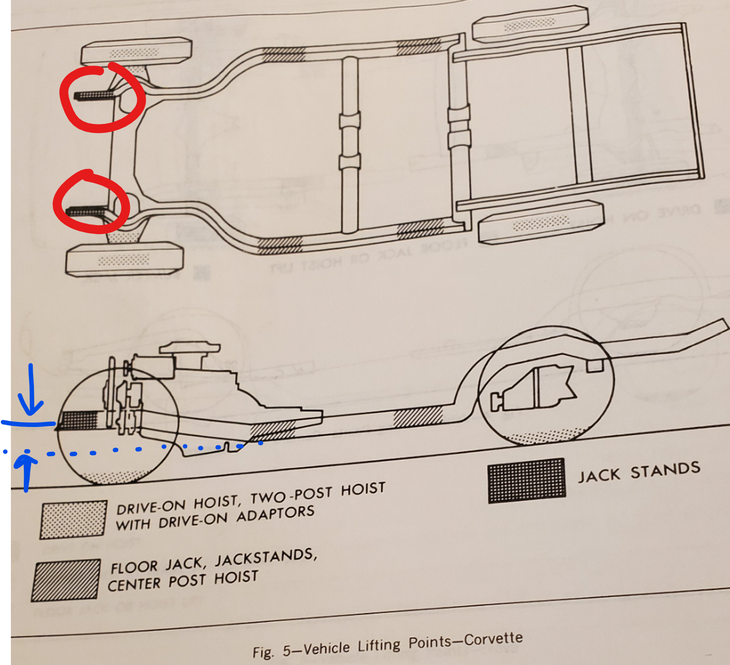

Ideally, I would leave it up on jack stands for several weeks as I go through the braking system, order new parts, and install them. I'm thinking of taking off the rear right wheel to take some weight off the leaf spring in the meantime. I wonder if the leaf spring may be bad (that seems difficult to replace).
Are you talking about the circled areas below? I put two jack stands there as a backup (you can't see them in the pictures), however they are not tall enough to contact the frame rails since that part of the frame is higher than the rest of the frame (see blue in image below)
I know the left caliper is leaking, where does it look like the right one is leaking?

Thanks for the feedback. Does anybody have any pictures of their car on jackstands, with a closeup of the rear jackstand in front of the rear wheels? I'm curious how it looks like for others.
I ended up moving my rear two jackstands to be more in the corner by the frame crossmember #3 before the frame jumps up. There's more contact there, and it's still pretty stable. Time to check out the leaking caliper...

Jack stands just don't match the profile of the frame rails, so rotate the stand until it makes contact on both "ears". Orientation of the stand when contacting the underside really doesn't matter; you want to try to achieve contact across both ears in order to exert equal downward force of the shaft into the legs.
