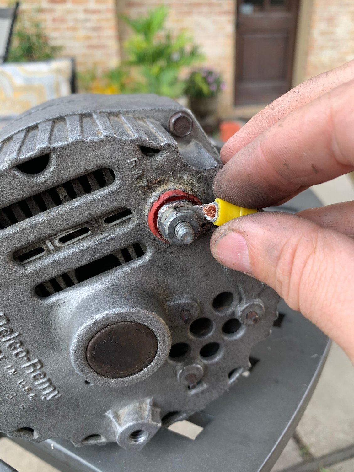

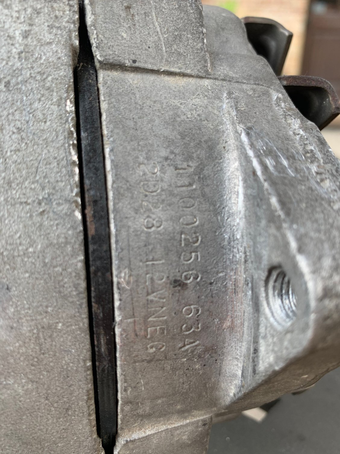

69 427...I have a delco remy 1100256 63A alternator. The nut where the power leads connect is stripped. I would like to replace it and am wondering if I should upgrade to a higher amp.
The car has vintage AC with a secondary cooling fan. I am also running a stereo with an amplifier. Planning on adding relays for headlights for a later headlight upgrade.

If you needed higher output it would be likely that the yellow plastic on that connector would be at least somewhat melted from the heat from the additional amperage demand.
my guess is so far you have not stressed the output of the alternator capacity.
that being said usually where the output falls short is at idle since the full output of the alternator is not available at that rpm.
