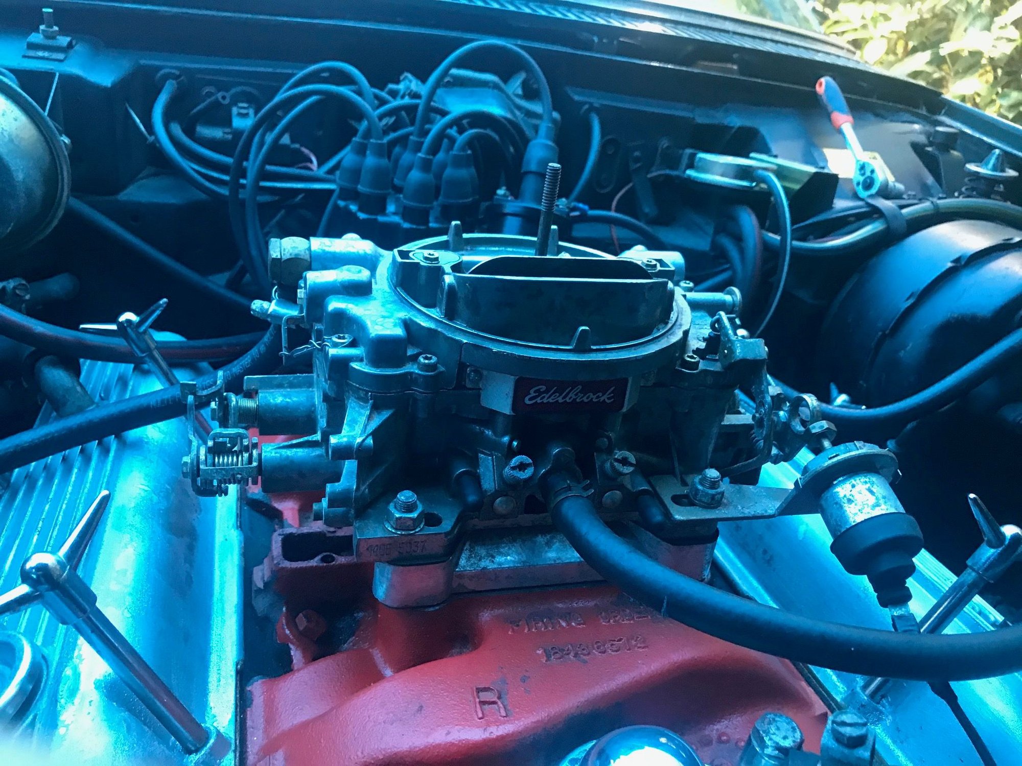

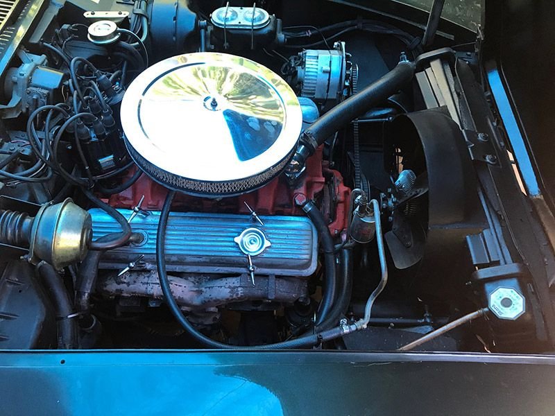

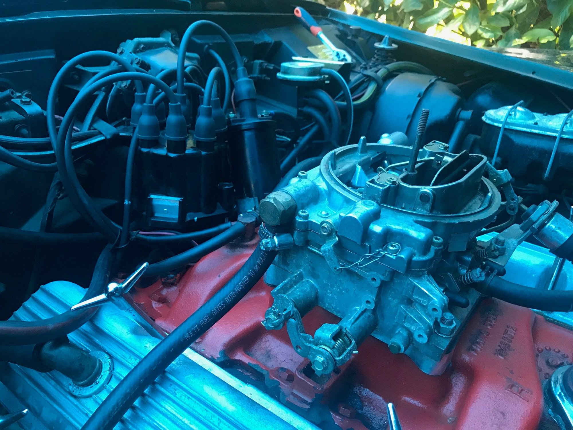

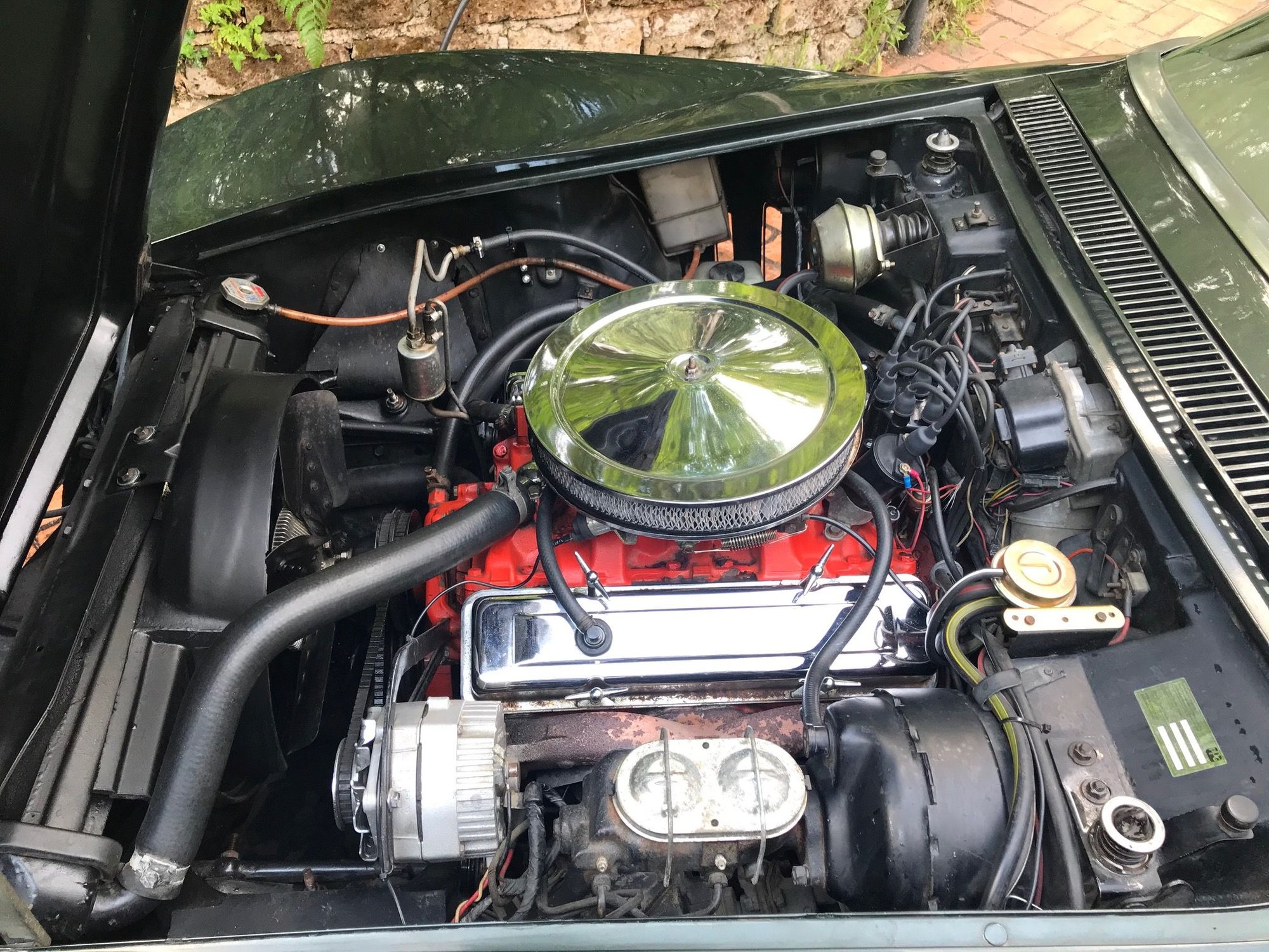

Can you post some pictures of your engine, preferably without the air cleaner in place?
Old Sep 2, 2020 | 09:40 AM
dru77's Avatar
dru77
Joined: Jul 2020
Posts: 30
in the following the pics of the engine:
if you need more details please ask me,
thank you for your help.
Old Sep 2, 2020 | 10:15 AM
Bikespace's Avatar
Bikespace
Joined: Mar 2017
Posts: 11,947
Likes: 4,506
Thanks!
No doubt there's a lot that others will see. My quick observations:
You have a looping, pressurized, rubber hose leading from your fuel filter to your carb. This is a huge fire hazard, but also very common. Your return line also leaves pressurized rubber hose in the engine compartment.
It looks like some of the functions of that carburetor have been removed or disabled. Is your choke always open? Secondary flappers always open? I'm no expert on Edelbrock carbs.
There are at least two capped vacuum ports on the front of that carb. One of them should have manifold vacuum that can go to a vacuum can on your distributor. You may be able to add a vacuum can (either the "correct" one, or adjustable).
I'm sure others will see a lot more.

no, unfortunally this vacuum advance is missing. I post some pics to be sure to well understood.
no connection between the distributor and the carburator. I guess this distributor has been placed by the previous owner
To carburator issue?

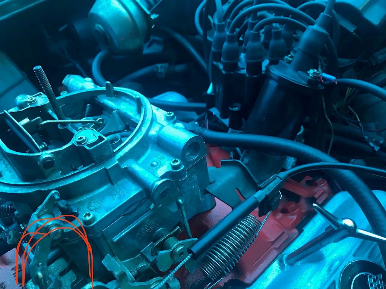

Old Sep 7, 2020 | 06:04 AM
dru77's Avatar
dru77
Joined: Jul 2020
Posts: 30
hello all,
the issue seems to related at the accelerator pump. yesterday I changed the hole in the leverage (sorry I don't know the correct name....see picture below) and now it woks better. is not perfect yet... I will buy a kit to
restore the pump.
thank you for your help and informations
