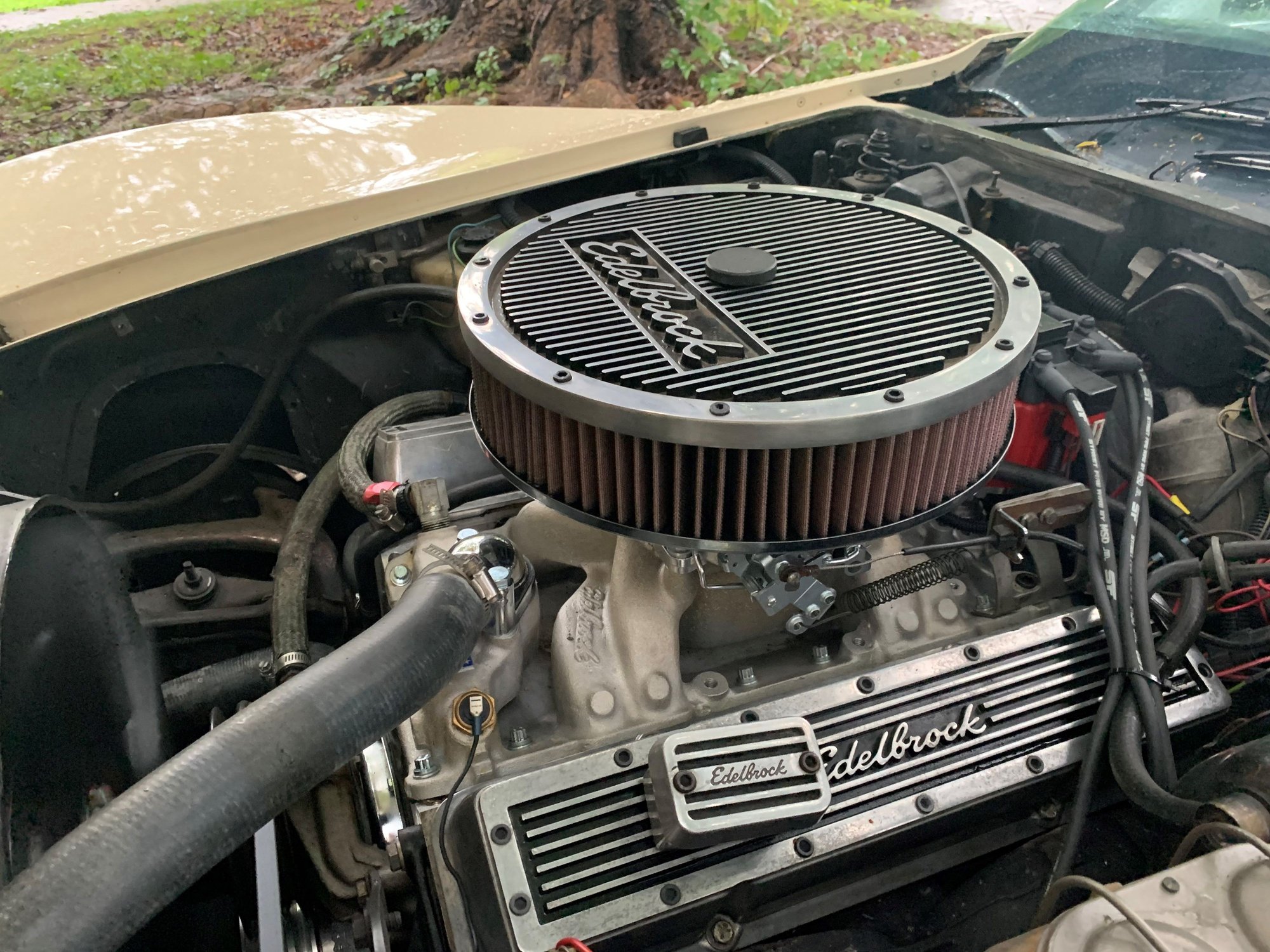

I was gonna make another post about this but found your post, not trying to take over but just had a question. I just got my 78 with 400 small block. Is this the PCV valve and if so do they usually seep a little? It is hard to see but there is a little liquid on in the grooves of the cover.
there is no PCV in your picture.
start a new thread
