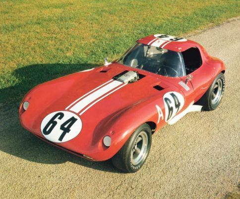

Originally Posted by Big2Bird
Best to Cheetah
this must be a light car...

2108 with driver.
Less than Miata, but double the HP.
215mph at Daytona.
Oh, 'bout 1650 lbs... with a race-ready 327 V8! (In the pic ^ you can see it's a Corvette Fuelie intake.)
Interesting story and quite a few vintage race videos on YouTube.

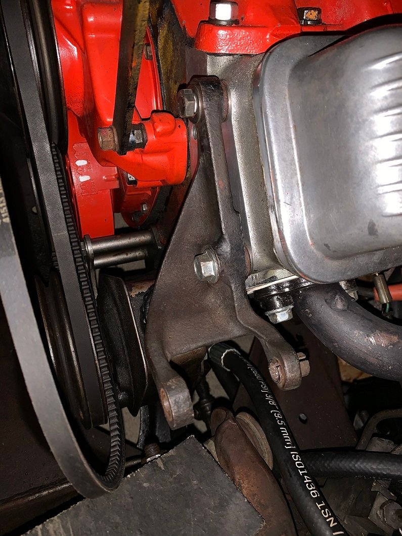

When I installed the 81-82 exhaust manifold on the drivers side I ended up using the cast iron 72-79 C3/truck cast iron lower alternator mount since the ex manifold had no provision for the 68-71 style lower bracket. Today I replaced it and installed the 80-82 aluminum mount saving another 2 lbs. It positions the alternator slightly lower and farther out so need to get a longer belt tomorrow.
R
