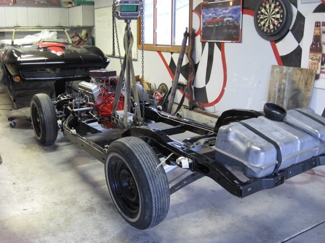

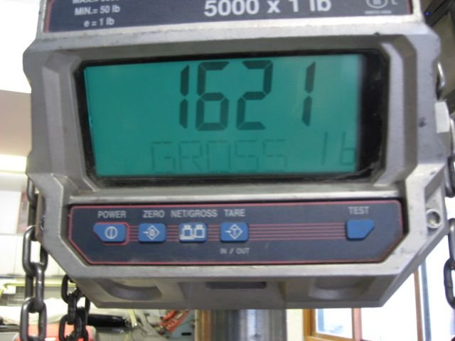

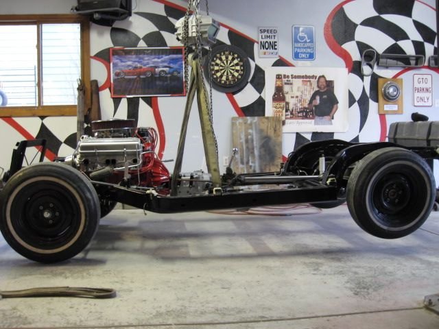

Weighing a complete rolling C2/C3 Vette chassis in my workshop with engine, tranny - everything except the body:
Crane scale attached to the chainfall, and lift straps on the rolling chassis:
1621 pounds. Everything over and above 1621 is body....
Lars

Great data point!
Plus radiator, fluids, 20 gallons gasoline, exhaust, etc.
Iron head smallblock or aluminum?
Intake?

Wow, that's one heavy body.
