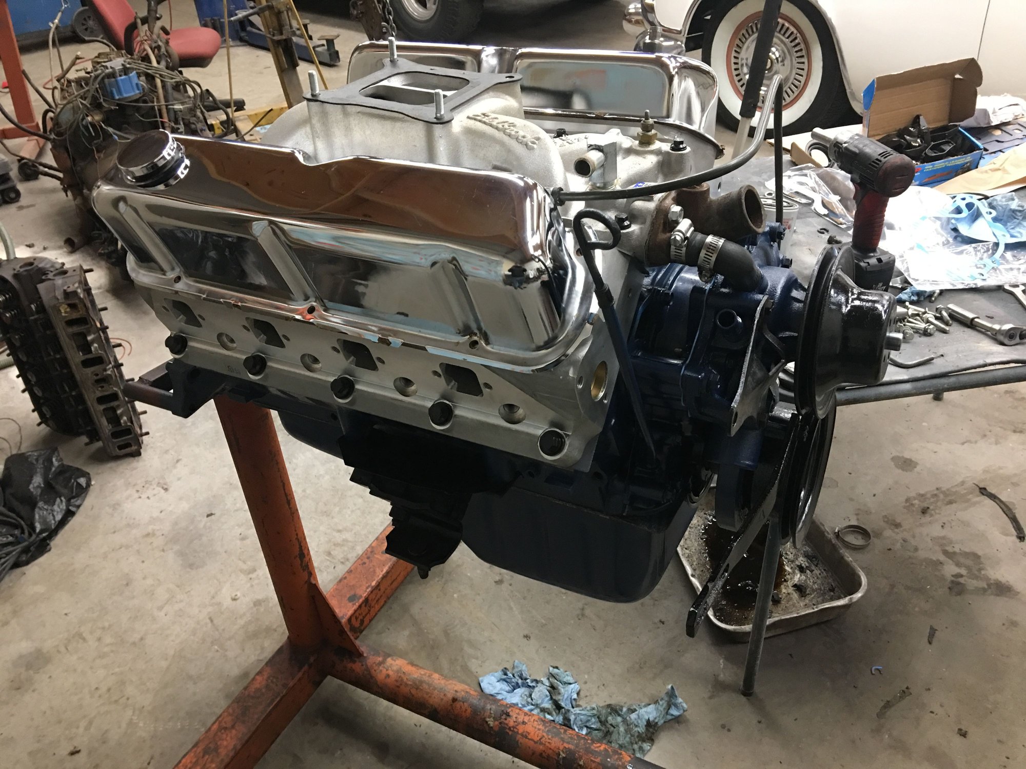

Have installed 2 of the Accel conversions with after market higher output coils in a 67 Ford truck with a 390, and a 65 Mustang with a 289. The 289 was a hot build with aluminum heads, and a stout cam, and valve train. It pulled hard to 5,000 rpm, and the points couldn't run any more RPM and it would miss/start to fall on its face. With the Accel conversion it pulls clean to 6500. I do still have points in several of my own cars so it just depends on what you are doing.

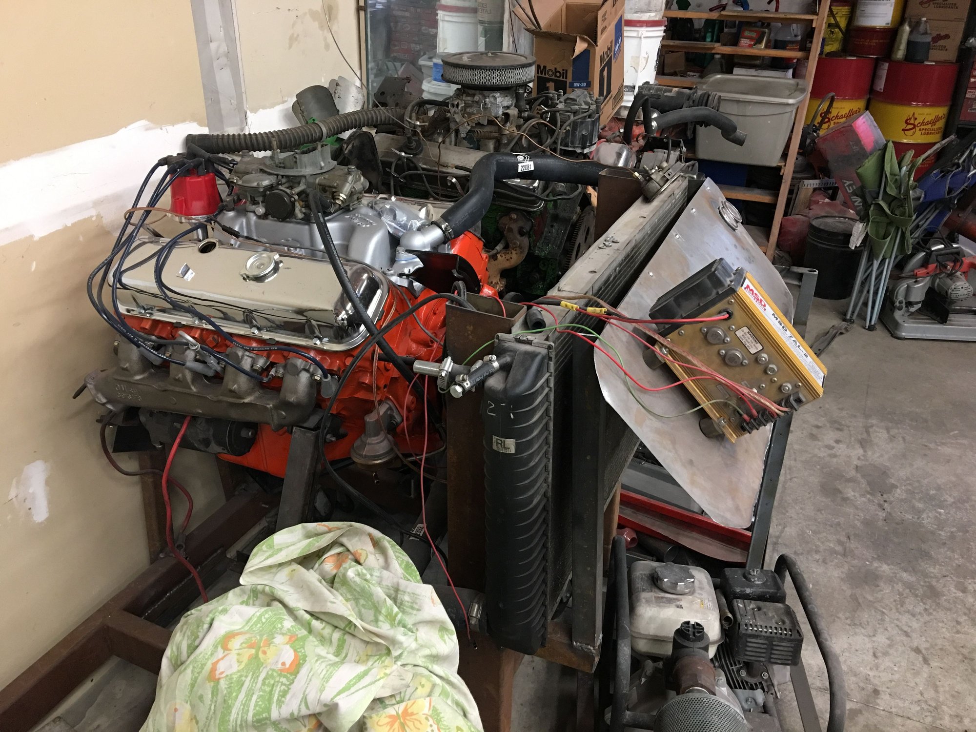

Upgrading to a MSD or similar with an external ignition box, and a hot coil definitely increases fuel milage, and lowers ET at the track because the spark is way hotter ( I have done back to back tests on this and the results are dramatic especially with fuel milage increasing)
The 289 just prior to installation
454 on the test stand with MSD 7 as the ignition test mule

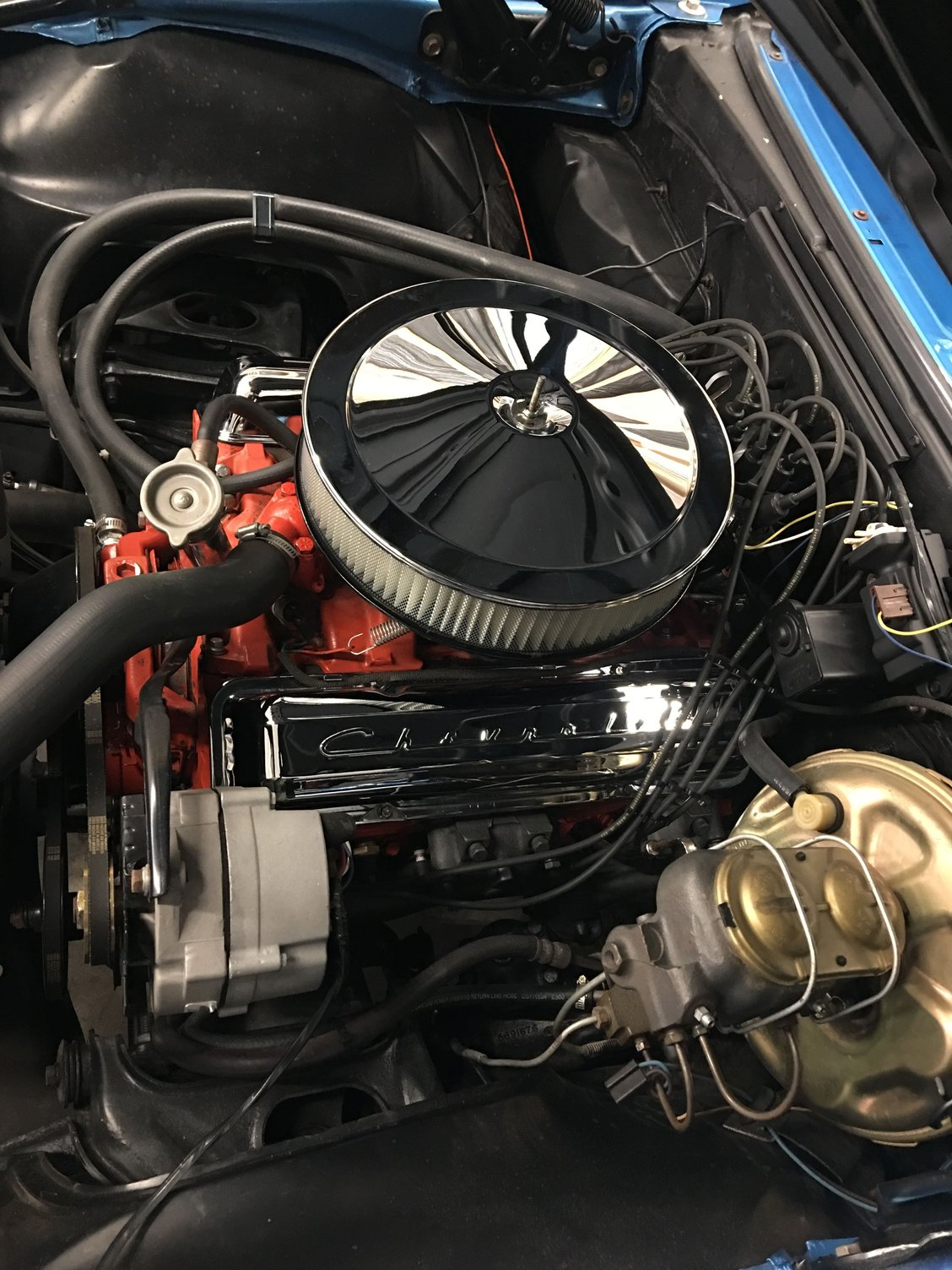

Yup little felt thingy with a tiny bit of grease for my own cars,
customer gets electronic maintenance free so he, and I don’t have any hassles
One of my own that still has points

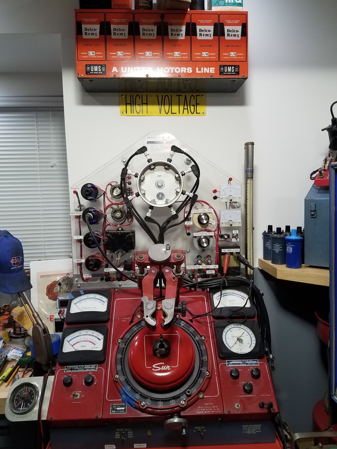

SUN made a machine [ Distributor Profiler } that spun up your distributor thru its RPM range . The exact springs needed for the mechanical advance could be determined to produce the best timing for your engine . { All In }

I haven’t seen one of those machines in probably thirty years. But I’d sure like to have access to one. It is certainly easier the CHECK the settings on the engine, but when you need to CHANGE the curve, it’s so much easier to do on one of these.

Not quite.
they are SUN Distributor Tester
I KNOW at least three folks on this forum have one; I do. I KNOW of several others not associated w/ CF.
http://www.paramountd.com/sale.html
afaik, most folks who race or use SUN distributor testers refer to the ignition advance map as "the curve"

Kinda like this?
There ya go.
