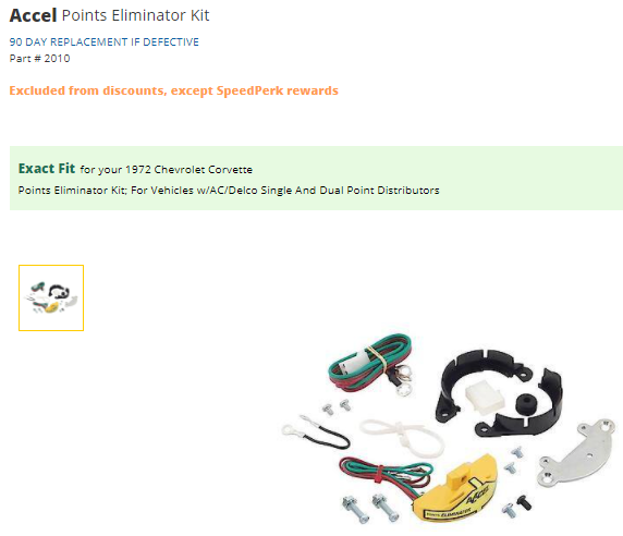

I am planning to replace my points, and noticed that there are kits to convert and eliminate points. What are your opinions and experiences with the points eliminator kits.
