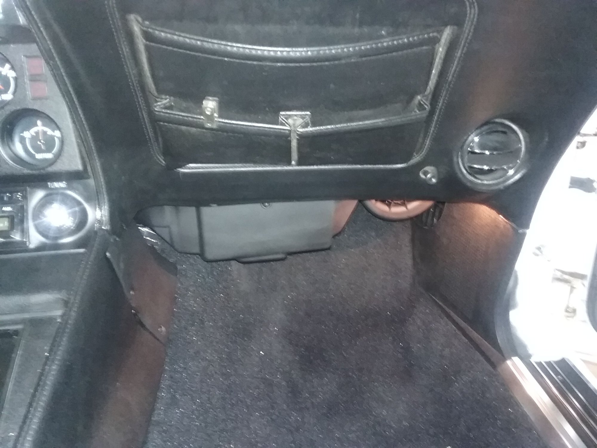

My only issue with the Vintage Air system is how much it impacts the interior of the car. It's very visible under the passenger compartment. The stock one takes up more room underhood but it leaves way more space inside.
Vintage Air 964173 is a "sure fit" system for factory AC cars.
https://www.vintageair.com/surefit/c...model=Corvette
Any pictures? I was under the impression that the VA system was completely hidden behind the dash. But if not, I guess I need to rethink my plans...
This is the "Sure Fit" install. Very visible. I caught my foot on it a few times.
Holy Cow! You’re not kidding. That looks horrible.
Looks like you had trouble getting it up.
On my VA install, I covered the exposed part of the housing with some matching carpet. Looks much better that way. If not carpet, it wouldn't be too difficult to fab up some kind of shield to hide everything.
