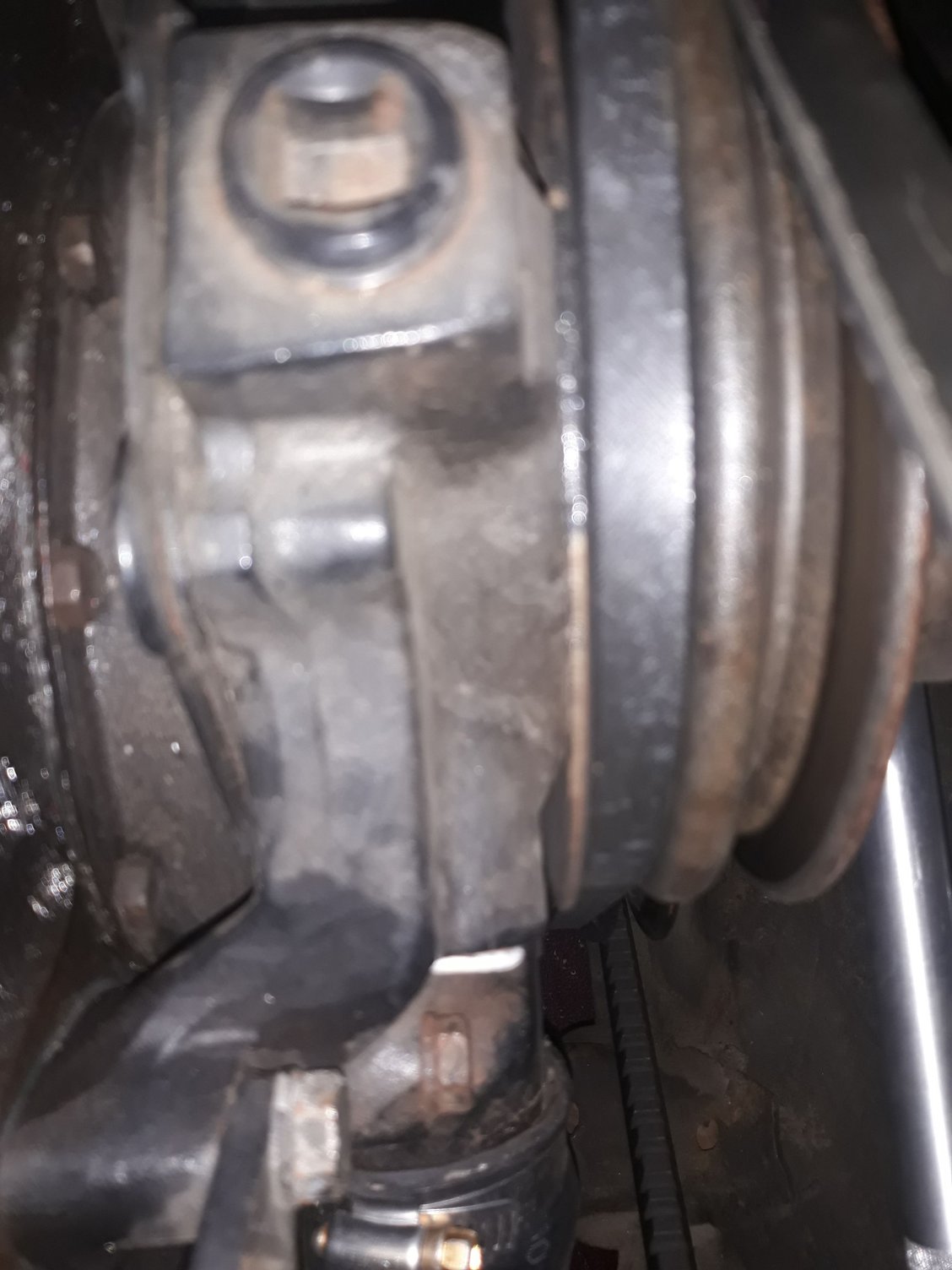

Here's a photo of the waterpump in my 77. Installed about 2005.
See how close the pulley is to the pump? No rubbing. Your being paranoid. No washers. Not a good idea. You'll put your belts out of alignment. If your belts are not fitting correctly, take them back and get slightly longer or shorter ones. Easy done.

OK - mission accomplished! Water pump is on, clearance which I was worried at almost a business card thickness didn't scrape once all was tightened. I found a set of Gates belts from the O'R store near me(wasn't sure if I could state their full name on forum). They were great and found the set that fit like a charm! Once reassembled, coolant added, fired up and no scrapes, rattles, belt slop, or leaks! Thanks again to all for the advice and ensuring I didn't go into a rabbit hole or point of no return. Hopefully this part/repair will hold up as long as the original.

Glad to hear you got it all together. Next time your at a car show, look at everyone's pulley to waterpump clearance. You'll see they all run close.

That's all I have, probably .015" at most
