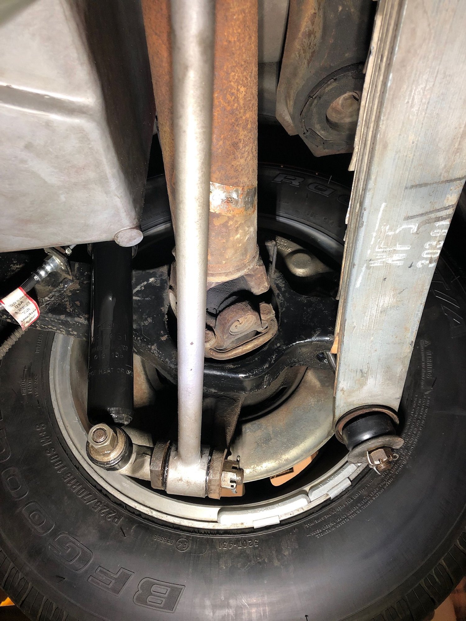

ive heard silver primer but my79 sure looks like Kentucky chromish gray..and this is after removing spray bombed rear undercarriage
196 sounds about rightfor my 9 leaf
