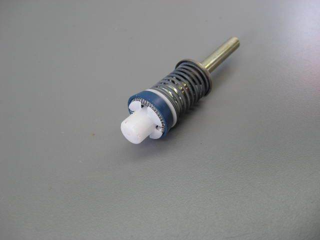

The accelerator pump on my '71 was sticking (not returning). I got it apart and plan to replace the plunger. However, I notice that my plunger does not have the top spring, also called the duration spring. Did all Quadrajets have this top spring? Is there a model number to confirm this?
I'm holding off reassembly until I get the definitive answer.
TIA
Russ

Yes, you should have a spring , see below
https://cliffshighperformance.com/pr...celerator-pump

All Q-Jet accel pumps have a top spring and a bottom spring. No exception. They cannot function without both springs in place.
Lars
