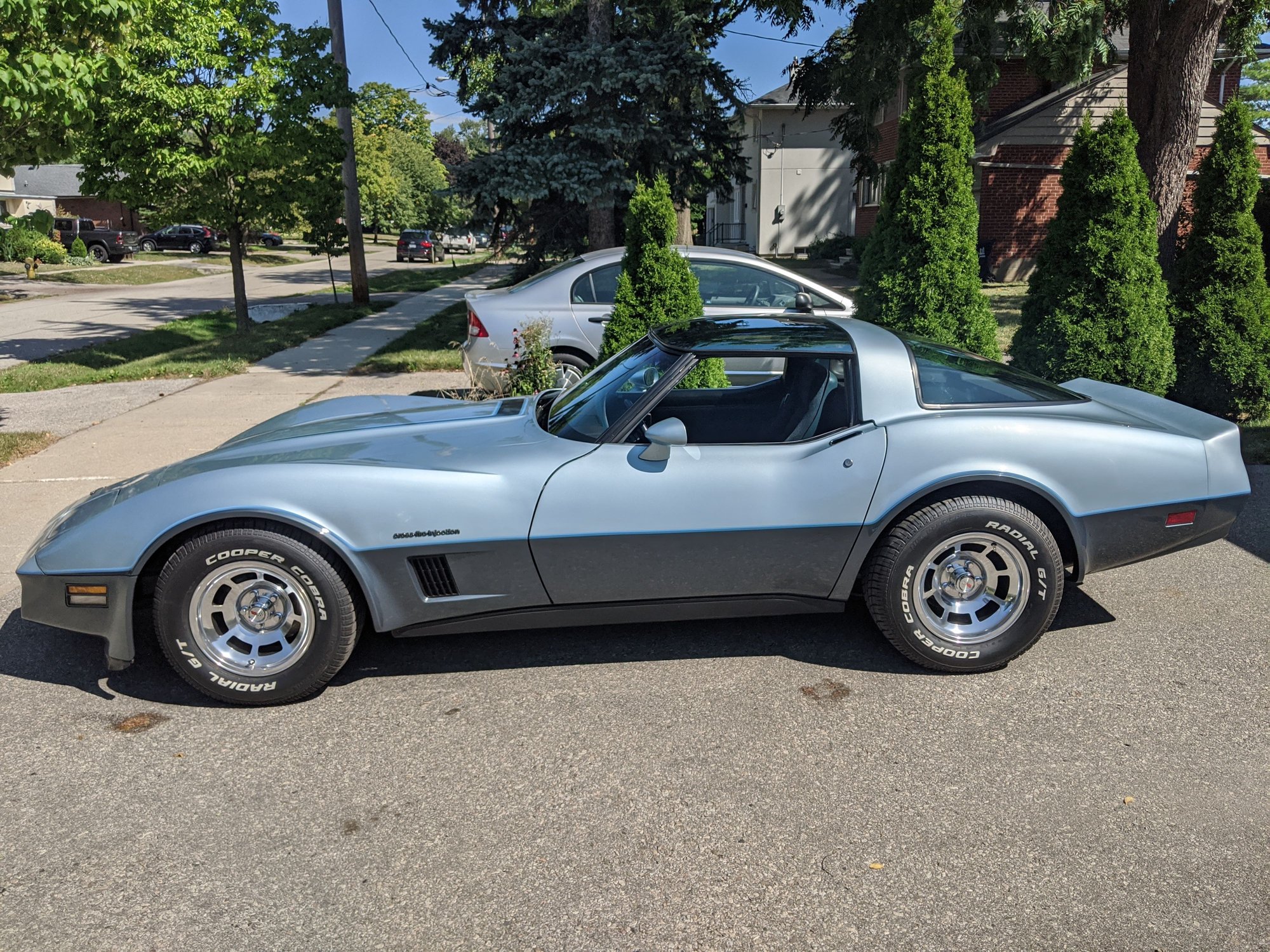

From: Toronto Canada
Brand new Cooper tires 255/60/15 not lowered

Old Oct 15, 2020 | 07:27 PM
trans am kev's Avatar
trans am kev
Joined: Mar 2020
Posts: 334
Likes: 113
just what i wanted to see are they 255 all round like the stance
Old Oct 15, 2020 | 07:34 PM
DarrellD23's Avatar
DarrellD23
Joined: Nov 2018
Posts: 295
Likes: 104
Same size on all four.
