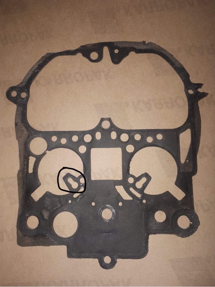

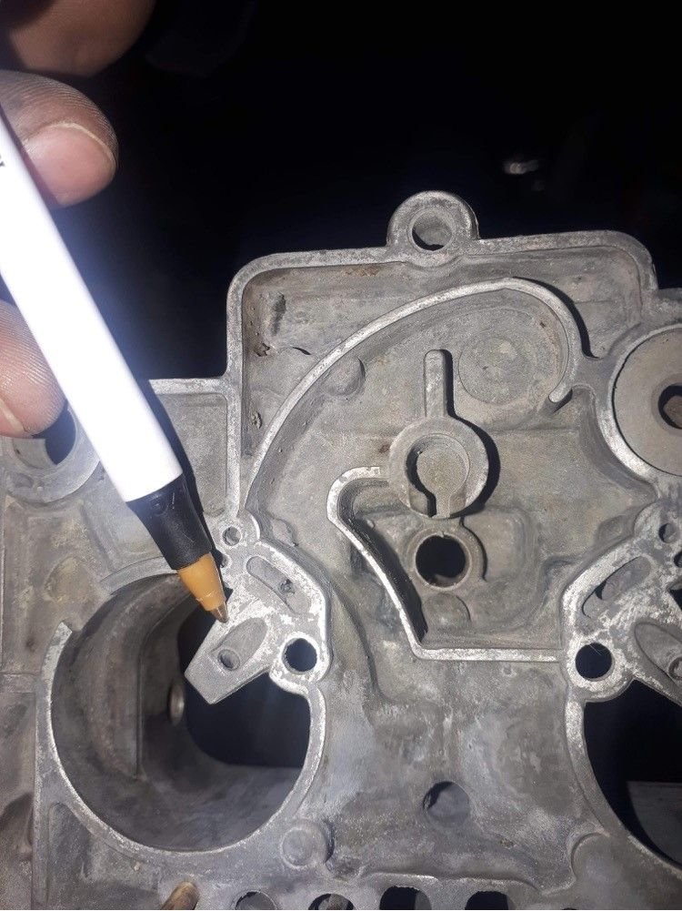

Hi all,
I have a 1970 Corvette 350ci/300hp, A/T. I purchased a rebuilt Rochester carburetor from a Corvette parts supplier back in 2012.
It was only recently installed on my 1970. There was a gasoline leak at the airhorn gasket... long story short, the airhorn had a prominent warp on it, and while trying to "fix" it, my mechanic cracked the airhorn.
I was able to source another used airhorn, but it is not exactly identical, but very very close.
I'm attaching a few pictures of my new airhorn (which is now cracked), and the old air horn that I want to use, and a picture of the new airhorn gasket, and the old airhorn gasket.
The only difference is where the pen is pointed in each picture of the airhorn. On the new airhorn, there appears to be a simple hole that is vertical... on the old airhorn, there appears to be a hole but on a 45 degree angle... and if you compare the 2 gaskets you can see where this difference exists where it's a "hole" on the new gasket, and more like a "tab" on the old gasket.
Basically my question is whether I can use the old airhorn on my new lower portion (bowl of the carb) with no issues? And would I need to use the old gasket if I use the old airhorn or can I use the new gasket on the old airhorn despite the fact that they are different where the circles are on the attached pictures.
Any insight would greatly be appreciated.
New airhorn (which is now cracked)
Old airhorn
New airhorn gasket
Old airhorn gasket

Looks like I have my answer actually... I had sent this same information to Lars Grimsrud, and he said they are not interchangeable... one is for a passenger car, and the other from a truck and that they cannot be interchanged. Truck carb parts need to be used only on truck carbs - no parts interchange with passenger car carbs and vice versa.
Thanks to Lars for his reponse.
Old Oct 19, 2020 | 11:45 PM
lars's Avatar
lars
Joined: Aug 1999
Posts: 14,380
Likes: 6,390
The truck carbs use a different booster venturi design than the passenger car carbs, intended to provide a stronger fuel metering signal to the main discharge nozzles at low rpm high throttle opening conditions (such as when you're pulling a horse trailer up a mountain pass at 2000 rpm...). Mating up with this special booster venturi design in the float bowl is a special design of the airhorn. In addition to having a different venturi/booster design than the passenger car carbs, the truck airhorns and the float bowls have completely different air bleeds and fuel bleeds to tailor the fuel curve to these enhanced booster signals. Even the throttle plates have different sized idle air bypass bleeds in them than the passenger car carbs. Thus, none of the major components (bowl, airhorn or throttle plate) can be interchanged between the truck carb and the passenger car carb - it simply won't work. But even if the airhorns shown were both from a passenger car carb, it appears that the one airhorn is from a 1974 carb (the truck airhorn shown is a '74 light duty truck, or a late-70's heavy duty truck). Due to changes made every year in air and fuel bleed calibrations of the carbs, it's generally a bad idea to try to mix-n-match airhorn/bowl/throttle plate parts between years (even if they're both passenger car carbs) - it's a really good way to come up with a really screwed up carb. The commercial carb builders (like the "new" carb you have) do this all the time, and sell "mix-n'-match" carbs that are complete junk (as you have now experienced). The carb was junk before you broke the airhorn - you did the world a favor by getting a commercially rebuilt carb out of service...
