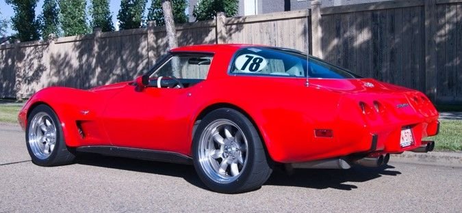

FWIW-My car above apart from the 17 inch ZR1 style rims and ultra high performance rubber ^^^^^^^^looks fairly stock including the 355 L-82 with about 425+ Gross HP, rebuilt/upgraded in 2014 by me. Open the hood with the GM blue painted motor, L-82 aluminum intake, GM dual snorkel OEM cold air cleaner, the way the roller cam 10.2:1 motor idles and you would never know it was not an OEM L-82 unless you look carefully, and/or step on the gas even moderately. I understand your view point.
With that in mind, 550 springs instead of 474 springs would not be detectable. Same for Bilstein HD and Sport shocks with the 7 leaf steel gymkhana spring, no one would know. Poly upper and lower control arm bushings in black would like wise go mostly unnoticed in stock upper and lower control arms and are so much more effective in the suspension with minimal ride quality degradation.
Adding a 7/16 inch OEM GM style rear bar would also go largely unnoticed and easily removable in the future and will dial out the inherent understeer in any C3 without a factory rear bar, as delivered from the factory. One compromise might be the competition heim jointed struts in the rear which will dramatically improve the ride (less unwanted movement than rubber), improve steering feel and handling, AND again, can easily be removed,in the future, and put back to stock easily, if desired or required.
My 78 has many reconditioned L-82 forged engine parts still in the motor (engine numbers match the VIN and the 4 speed transmission, as well) like the L-82 forged crank, L-82 rods, L-82 aluminum intake,etc. The interior is almost 100% stock C3 except 80 style C3 seats. The suspension is 100% GM OEM design with updated with modern, and in some cases different material parts, BUT 100% GM concept. I wanted to keep the car as much as GM designed it BUT with improvements using that basic design.
Most importantly, as long as you save ALL OEM parts, you get the benefit of a much better C3 that can be returned to stock at any time.

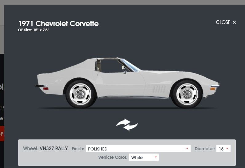

You mean like these? They exist. Have been eyeing them myself on my frame off resto. 17 or 18 inch 7-10 inches wide, and custom offset. And factory centercaps fit! I just may bite the bullet and try them.
https://www.americanracing.com/produ...s/vn327-rally/
Two piece aluminum, cast center, custom offsets.
Up to 18 x 9.5 with a 4.75 backspace is what would fit as a bolt-on from my research. Fr & Rr. With 10" wide rubber.

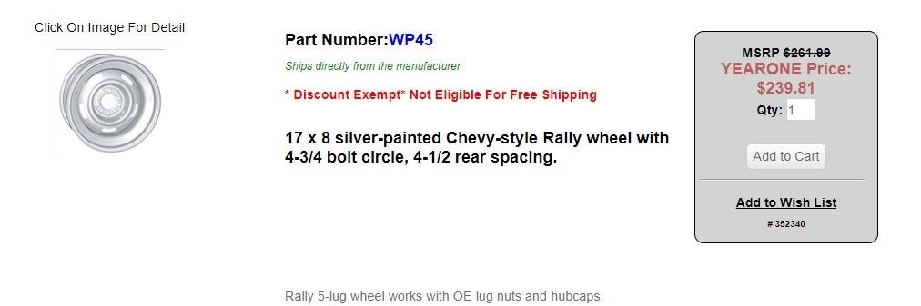

Year One makes a one piece cast Chevy Ralley wheel for our cars (WP45) . 17x8 only size available. Zero offset. (Would prefer 1/2" may need spacers) but only $240. But tire selections in the 17" size are rapidly dwindling.

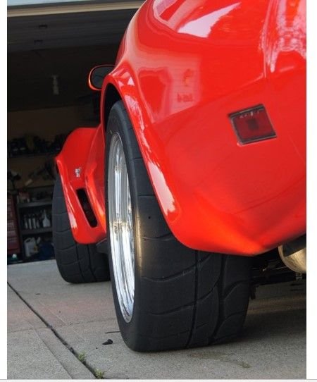

Cargotzman runs the LT 111s above. in a massive 18x9.5 inch size with a factory 1/2" offset and 4.75" backspacing. With massive 10" wide rubber. 275/40-18. I think it looks awesome! And would look even cooler with the ralley wheel look.

The Rallye Wheels from Year One (WP45) looks good and are not (too) expensive...but always without correct chrome trim rings for 17-18''...
