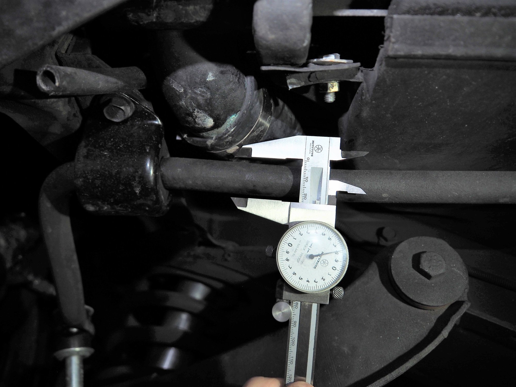

Tonight, I've checked the front sway bar replacement.
What my surprise to see that's, for me,impossible without modification to mount a bigger than 15/16'' front bar on a LT-1 Corvette :
My caliper is, of course, on mm scale (I'm in Switzerland!), but the dimension 23.8 mm match the 15/16'' bar diameter.
We can see quite clearly that the radiator hose will hit a bigger sway bar !
I think this is due to the special copper radiator for the LT-1 model.

There's a dimple in the radiator outlet to clear the later cars 1 1/8 swaybar.
I've seen posts of people who spaced the pillow-block away from the car to provide the clearance required. @interpon documented it, here:
