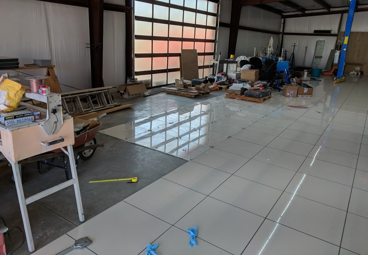

Old Oct 27, 2020 | 04:37 PM
northPhoenix's Avatar
northPhoenix
Joined: Oct 2020
Posts: 25
Likes: 7
From: scottsdale
Thanks guys. I realize i am soooooo lucky. This is part of my "for ever" home. As a DIY job it took many weekend sprints and my knees still hurt. The perimiter last row is still not done. You guys are so helpful!
porecelain tile floor
Old Oct 27, 2020 | 05:13 PM
lars's Avatar
lars
Joined: Aug 1999
Posts: 14,380
Likes: 6,390
I still say it's gonna' get slick when you get snow on it.... and your studded snow tires are going to scratch it...
