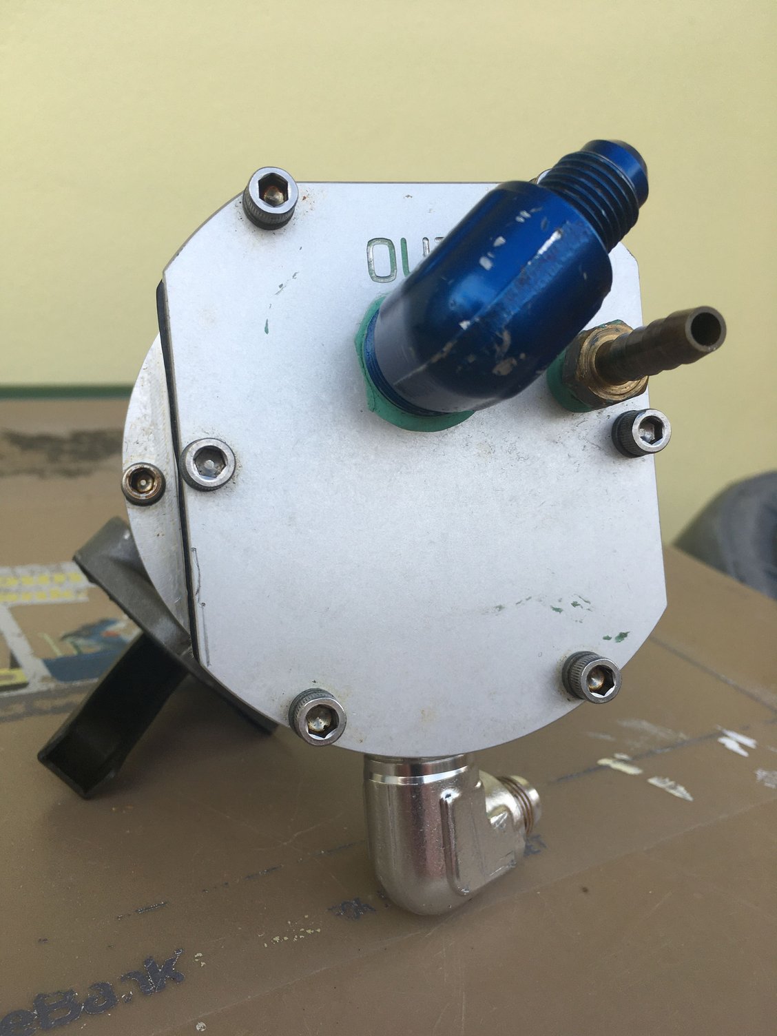

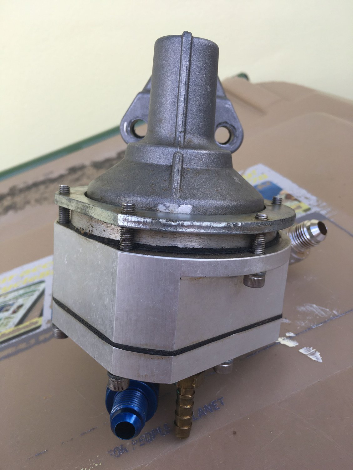

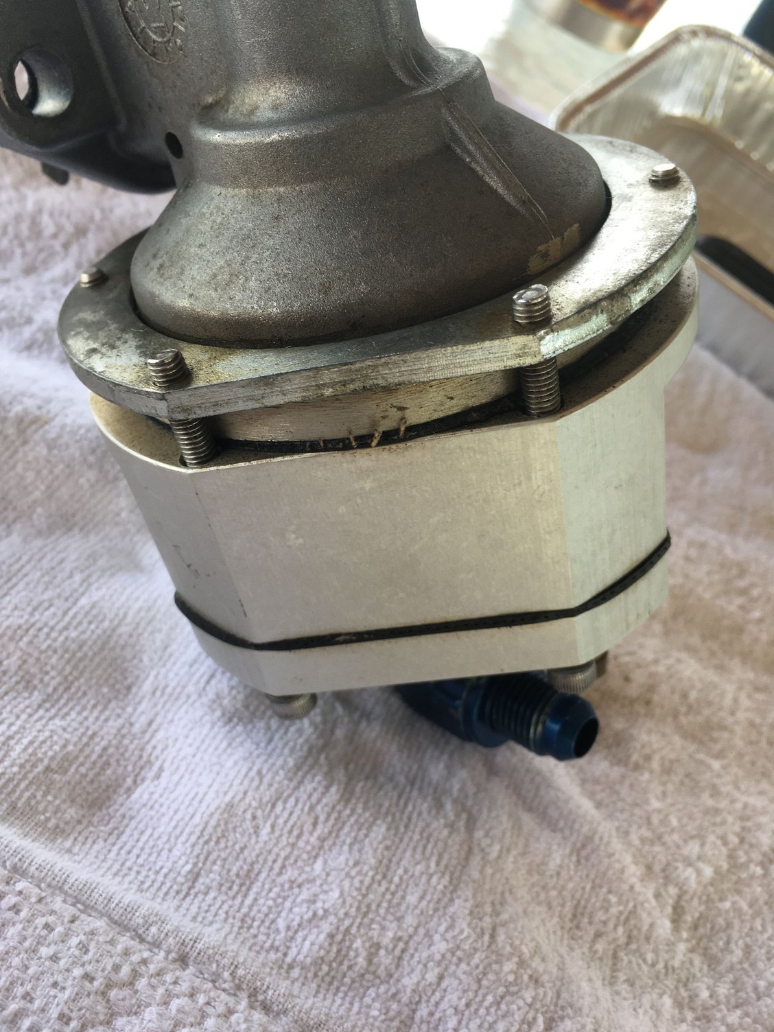

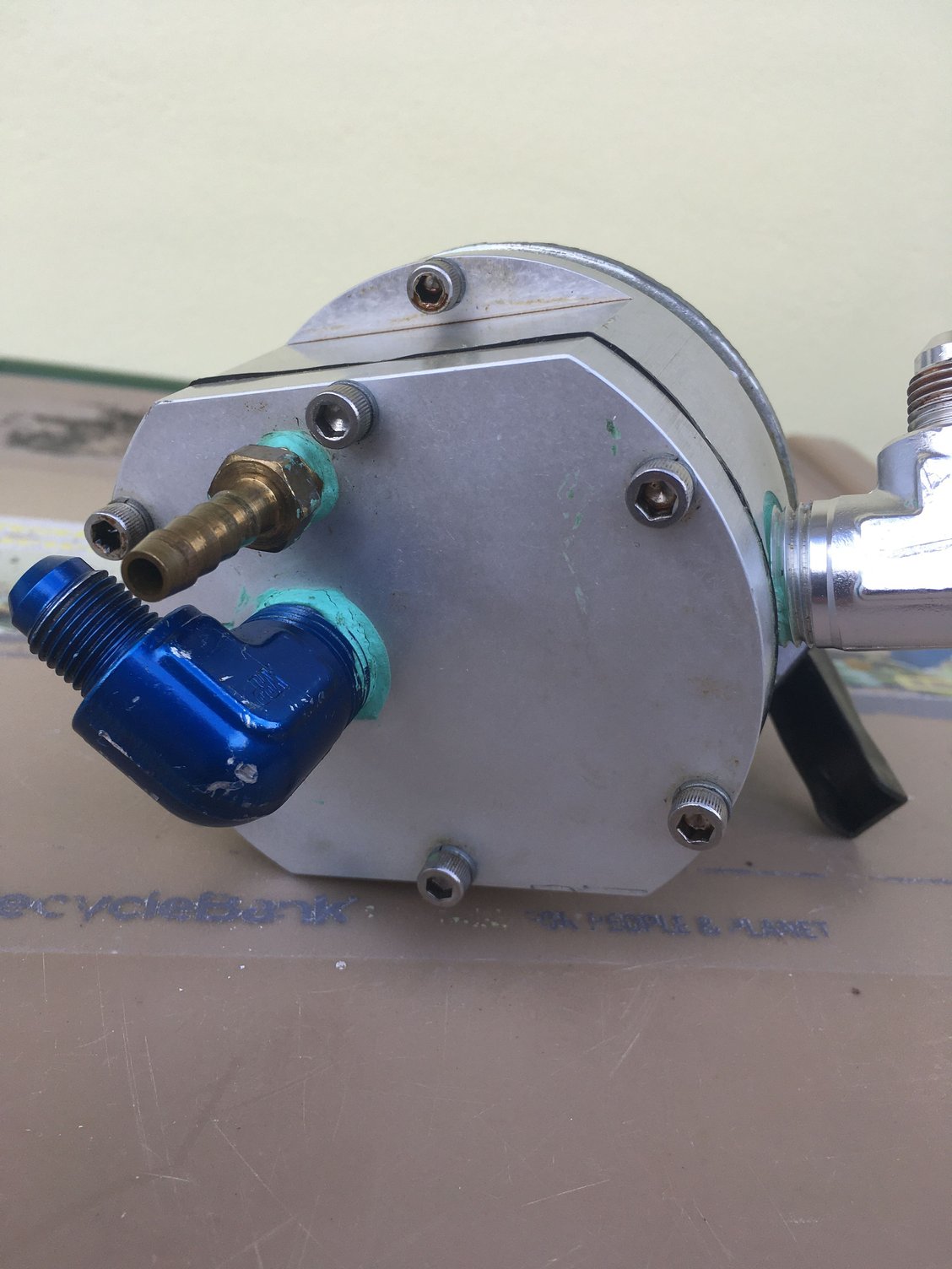

Hi Guys. I made the mistake of leaving fuel too long in the tank. I replaced the tank, sending unit, flushed out the fuel line, and then opened up the fuel pump. The large round diaphragm is crumbling, and the metal plate corroded. The pump is being used on a 383 built from the original 73 L-82. It is not a stock original pump. It is designed to allow the top and bottom parts to be rotated, which was helpful due to all the "stuff" right in that area. A flat plate on the bottom has a threaded fitting for fuel out to the carb, and a smaller one for the return line. There is one threaded fitting on the side, for fuel into the pump. I have looked at catalogs for the big name parts companies, and at numerous photos, no luck. Was considering a rebuild kit. Anyone recognize this type of pump? Thanks for any thoughts.

That's a home-made part built by someone with a machine shop. Nice setup built by someone who knew what they were doing, but you're not going to find any "rebuild kits" for that custom pump, unless you can track down the machine shop that built it.

That pump looks just like my RobbMC pump see pic below. It is a real good pump and has a great GpH flow. You might want to give them a call about a rebuild kit.

That is it, I recognize the company name on that letter head. Thanks! I will look into it.

My previous post was mostly correct, "built by someone with a machine shop. Nice setup built by someone who knew what they were doing."
