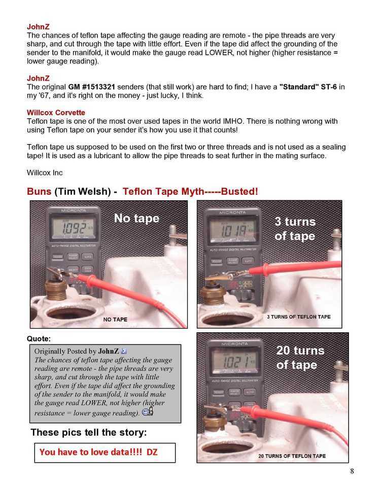

Originally Posted by HeadsU.P.
The average Joe will install a new temp sensor with a gob of thread sealant. This action keeps the unit from grounding itself to the head. Or in laymans terms, denies a complete circuit.
Two options when installing. Only use sealant on the bottom few threads. Or use sealant tape. The threads will cut the tape for good contact, yet seal-in coolant.
If your name is not Joe, you don't have to worry about it.
I've always wondered about this - how a sensor (or spark plug for that matter) can ground if you have sealant or tape on the threads. On spark plugs I use a little anti-seize which looks like it might conduct current - not sure. But sealant on a sensor definitely would hinder electrical conduction. Sound like what you are saying is just use a small amount of tape.
This is from the corvette forum that was posted:
One thing about pipe threads is to not over-tighten. It distorts the sealing properties and/or cracks the area around the hole or pipe. This is probably not possible in an engine block but you never know. I put my temp sensor in dry years ago and it's never leaked. I did use a little anti-seize as my temp sensor is in my aluminum intake but my anti-seize is copper based so the electrical connection is good.
FYI - Thread tape is not a sealant, it's a lubricant and to work properly as a lube it needs to be installed so that it doesn't bunch up when screwing it in.
