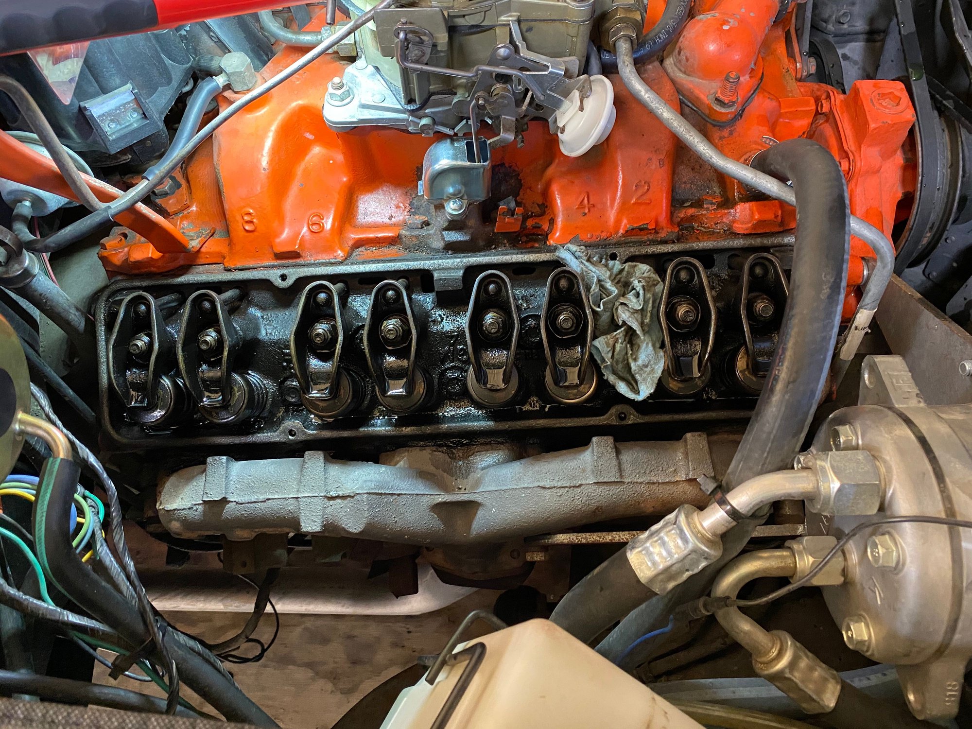

Originally Posted by ren80
Thanks Lars
I am going to use the felpro cork gaskets and seal them to the valve cover and straighten them as best I can. No sealant between gasket and heads. The rail along the top of the heads the cover sits on is not machined, its a raw cast surface which worries me it but sounds like this shouldn't be a issue. I will get to it this weekend.
Thanks all!!
You can just hit the head sealing surface with scotch-brite pad (green or white, green is more aggressive) to knock the crud off and clean up and dirt or small casting bumps (if cast iron).

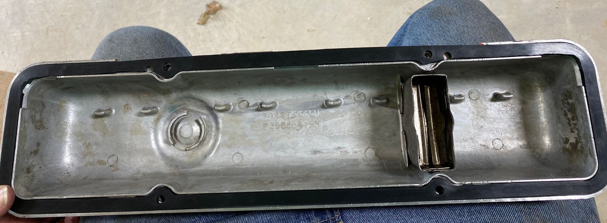

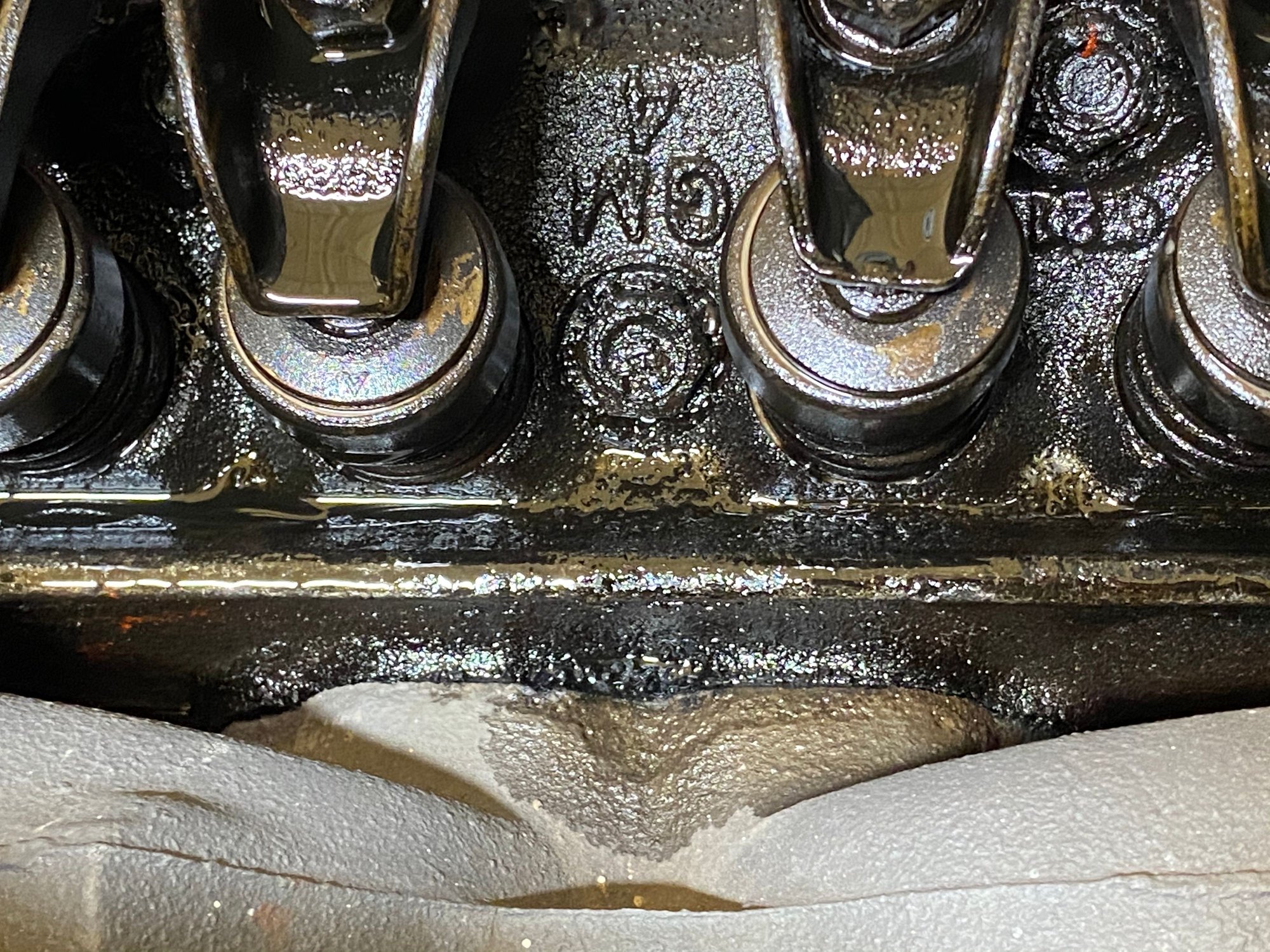

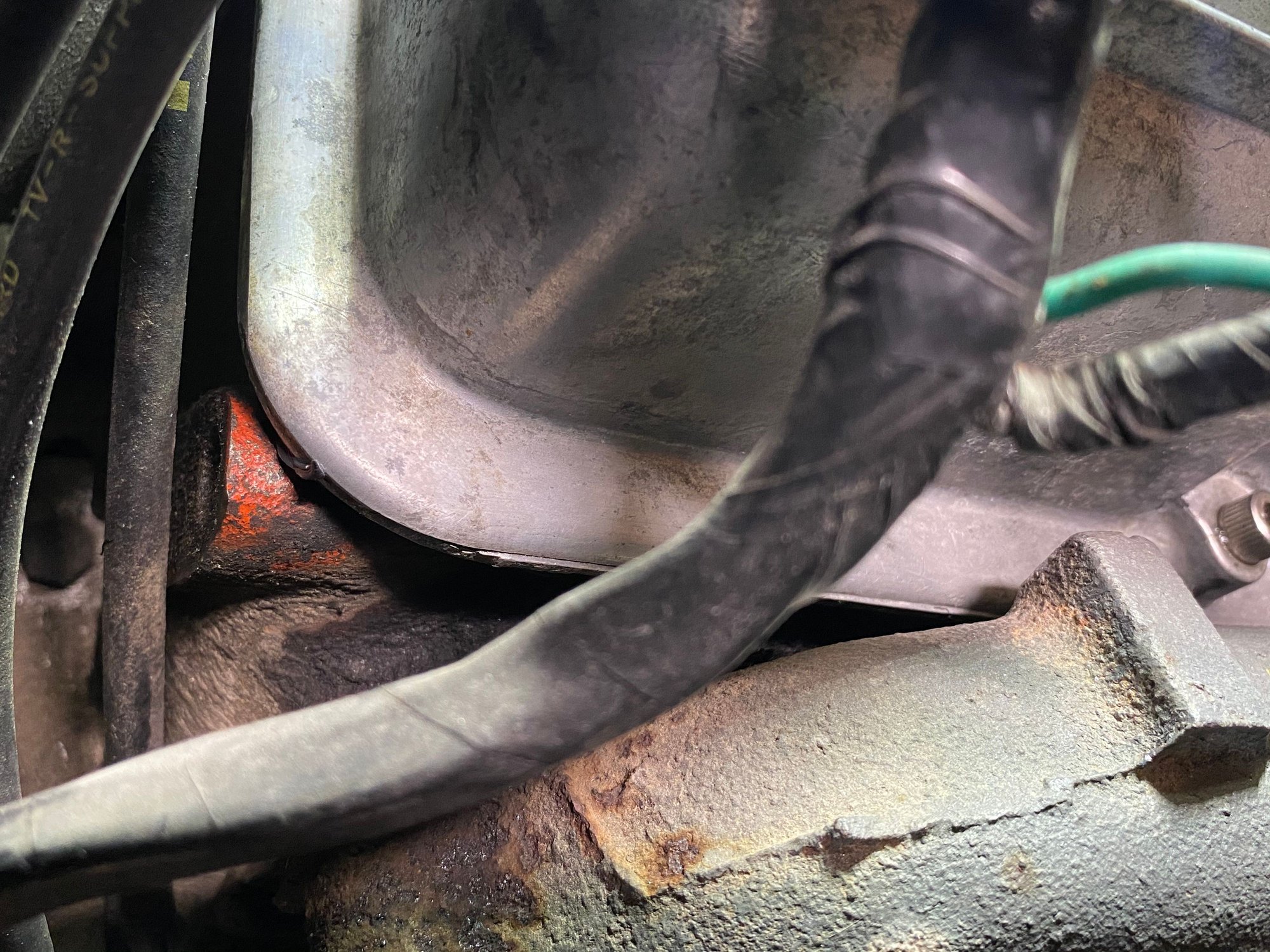

I just did this on my L48 ... first time I've done this in 30 years, too.
raised on cork and clear RTV. never had a problem ... but OReillys didn't have clear RTV .... nor cork gaskets. So, I have black RTV and rubber gaskets, which I had to trim.
ditto the clean/clear surface for silicone. that's a challenge on the textured surface of the head ... and keeping the debris from falling into the "pit" (mercy, I'm losing my mind ... where the pushrods/lifters are above the block ... that area between the block and the intake manifold.
But so far, it's sealed up nice. The bolts were barely finger tight on those cast aluminum covers.
BTW @lars QJet. Thanks again, good sir.
L48 original engine. Overhauled in the late 80s.
a bit slobbery
black RTV? well, OK?
can see where I had to trim the gasket.

After running a few 40+ mile excursions, holding so far.

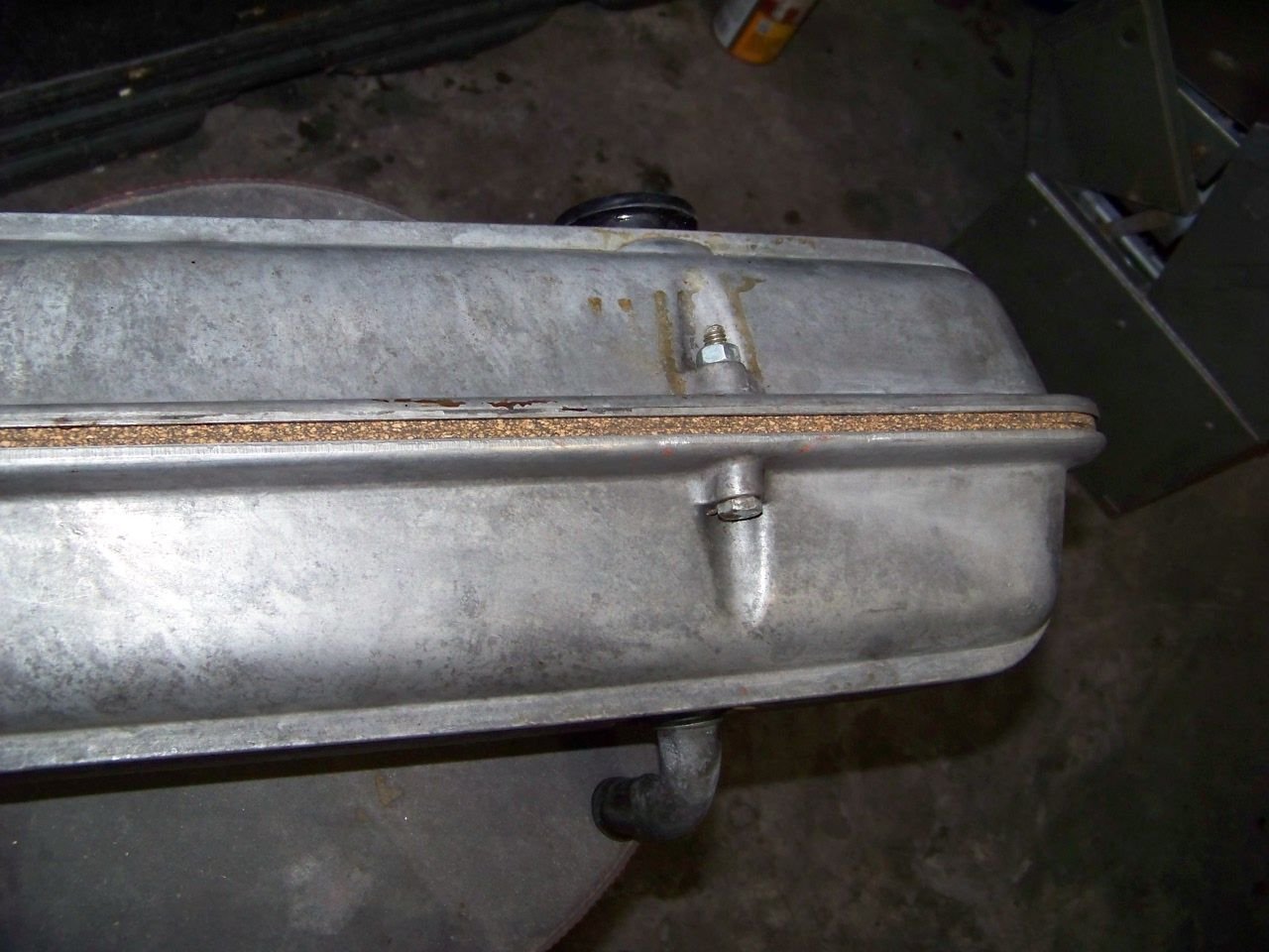

On cork gaskets in aluminum covers I use the shellac to glue the cork in place then bolt the covers face to face to set the gaskets - prior to installation on the car I then wipe the sealing edge which goes against the head with some axle grease so it will release the next time I remove them.
I have always been able to remove covers without sticking or incident.
