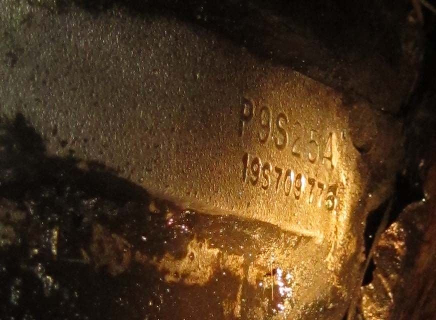

4. I also have a Muncie 4 speed transmission with the angled gears. It has an aluminum case but that's all I really know about it aside from the guy I got it from said it shifted great. How do I figure out what it is?!
muncies have an A/B/C stamped above the partial vin stamp. a = standard wide ratio m20. b = narrow ratio m21. c = strait cut gear m22 ("rock crusher"). mine is a m20
google results "how to identify muncie transmission":
https://www.chevydiy.com/muncie-4-sp...ication-guide/
http://www.superchevy.com/how-to/tra...d-input-shaft/
https://www.ecklers.com/pit-stop-blo...dentification/
r

If the OP’s Muncie is from a 68 it won’t have the letter stamped on it indicating whether it’s a M20, 21 or 22. That started in 69.
So I took off the side cover and counted the teeth on the first gear. There are 26 of them. No groove on the input shaft either. Also, no drain plug on the bottom. I think Sully called it as there's no letter on the case.
