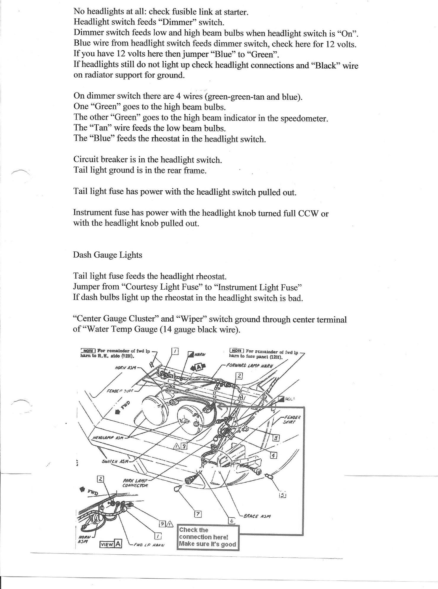

with your test light. check for voltage to the dimmer switch. then check for voltage out of the dimmer switch, should move from wire to wire as you click switch. if you have power to the dimmer switch. and then out, start following the wire's. connection at firewall, etc. if you don't have power to the dimmer, back up to the headlight switch.

Peterbuilt's Avatar
Peterbuilt
Joined: Aug 2006
Posts: 7,426
Likes: 1,559
From: mount holly NC
Default Does this help?

Thanks so much guys. I didn't have any voltage at the new dimmer switch so I pulled the dash back to check the connector on the new headlight switch I had just installed. Somehow the wire connector pulled out of the headlight switch when I was buttoning everything back up causing a loose connection. I plugged it back in firmly and I now have headlights.
Your valuable information helped me a LOT and saved me a lot of time and I am very thankful for your help.
