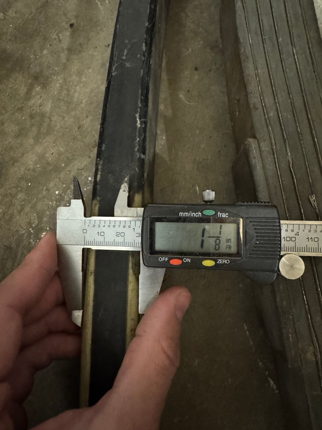

As per the thickness of the mounting pad. Sorry I'm way to lazy and sore to crawl under my car and measure.
Should be easy to figure out. Put bottom plate on spring. Insert bolt. Measure how much bolt is above spring. Allow about 9/16ths inch of threads. You have your measurement.

Thank you, that’s a really good idea! I also have another 7-leaf laying around so I measured
the thickness of that compared to the composite, which should be enough I just wanted to see if anyone could confirm.
The composite spring measured 1-1/8” thick and the 7 leaf is 2”. So with a 1/2” delrin spacer, the pads should each be 3/16” thick. Considering they are poly, my guess is they may be 1/4” and then compress when everything is bolted together.

What I find odd is the fact Van Steel instructions (with their low arch spring) say to mount the spacer on the bottom. They claim it will give you more ride height adjustability. I guess it will also provide more clearance from the heat coming off the rear exhaust pipes.
It almost seems like that spacer was only used to allow you to re use the original length mounting bolts. If one were to buy shorter mounting bolts (the correct length) the spacer could be eliminated. The composite spring still requires the upper and lower pads however.

After doing more reading on here, I think I’m going to try shorter bolts rather than a spacer. I bought some 1/8” thick 90A durometer polyurethane that I will use on either side of the spring as the spring isolators.

The installation instructions actually say to install the spacer under the spring, not on top. That’s why I decided to try the shorter bolt option instead.

I believe your on the right track if you do not have a spacer. Proper thin pads and shorter bolts should provide the same end result.
Those instructions are if your useing the stock length bolts,, and 'NEED' a spacer.
