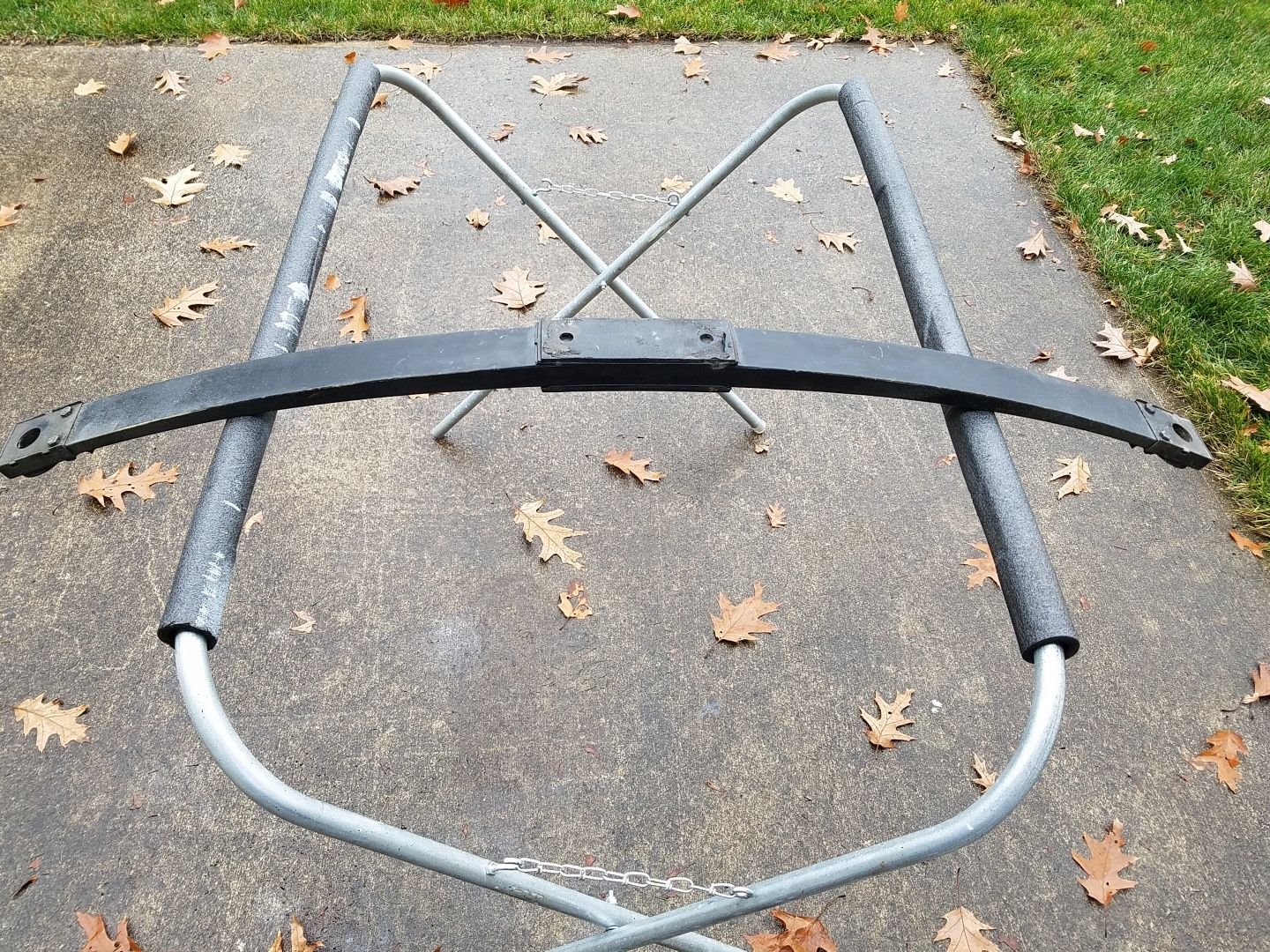

Picked up this composite spring for My 73 vette....Not sure what brand it is.....I guess I need the mounting bracket ? Looks like there should be like a one inch spacer that goes in the middle ...Anyone know where I could get the mounting hardware ?
It looks like it could be ride tech ?

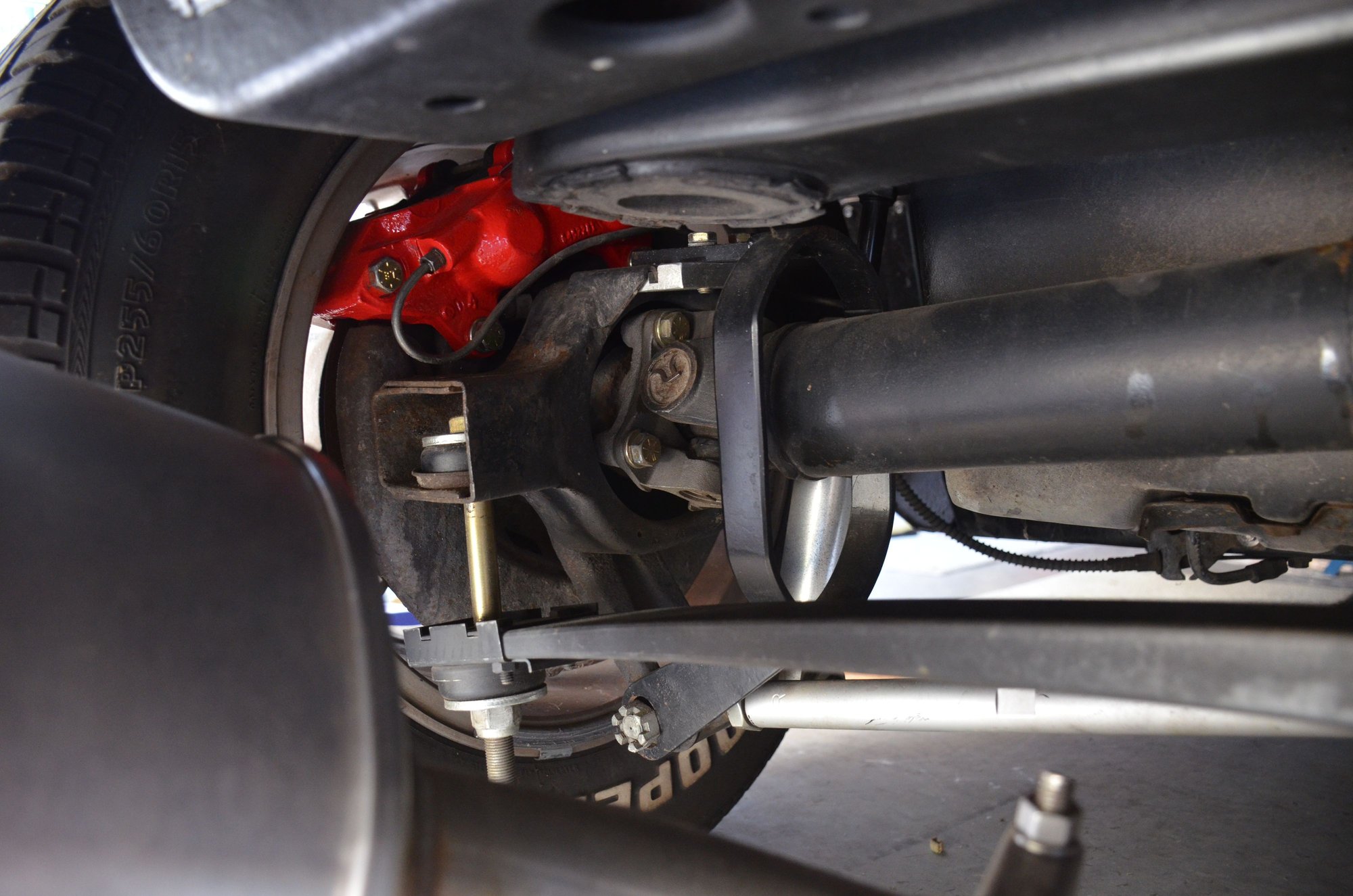

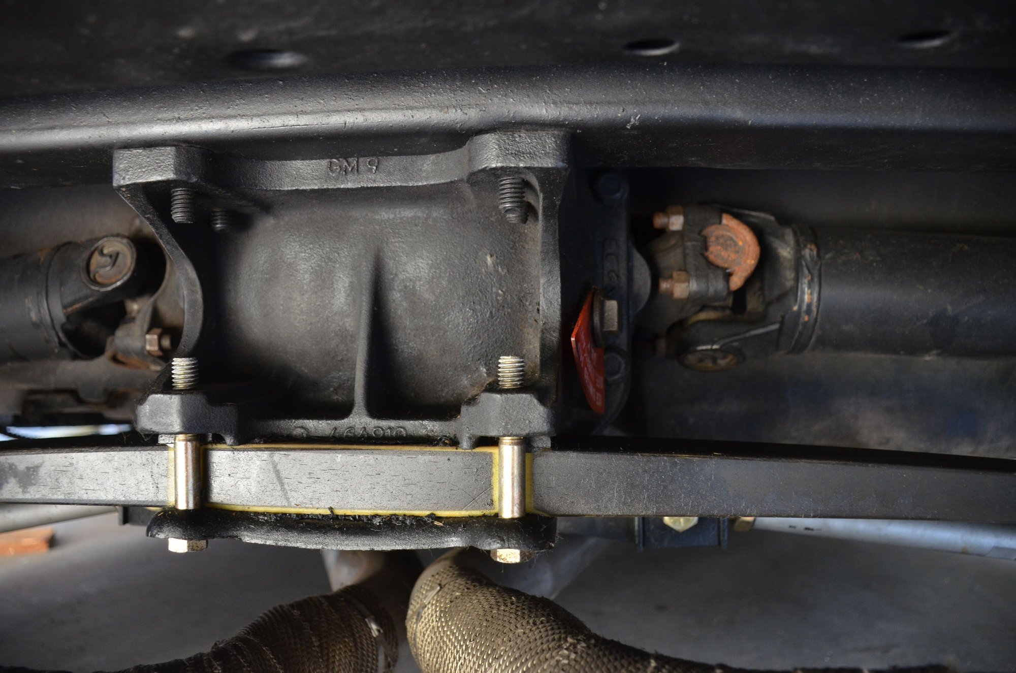

It looks liked a VBP spring to me. These pictures show the one I have on my car. I recently talked with Van Steel. They have a mounting kit that they said works with a VBP spring. It has a spacer. The installation I have shown here has no spacer. I ordered from VBP when they were in business and this is all I got.

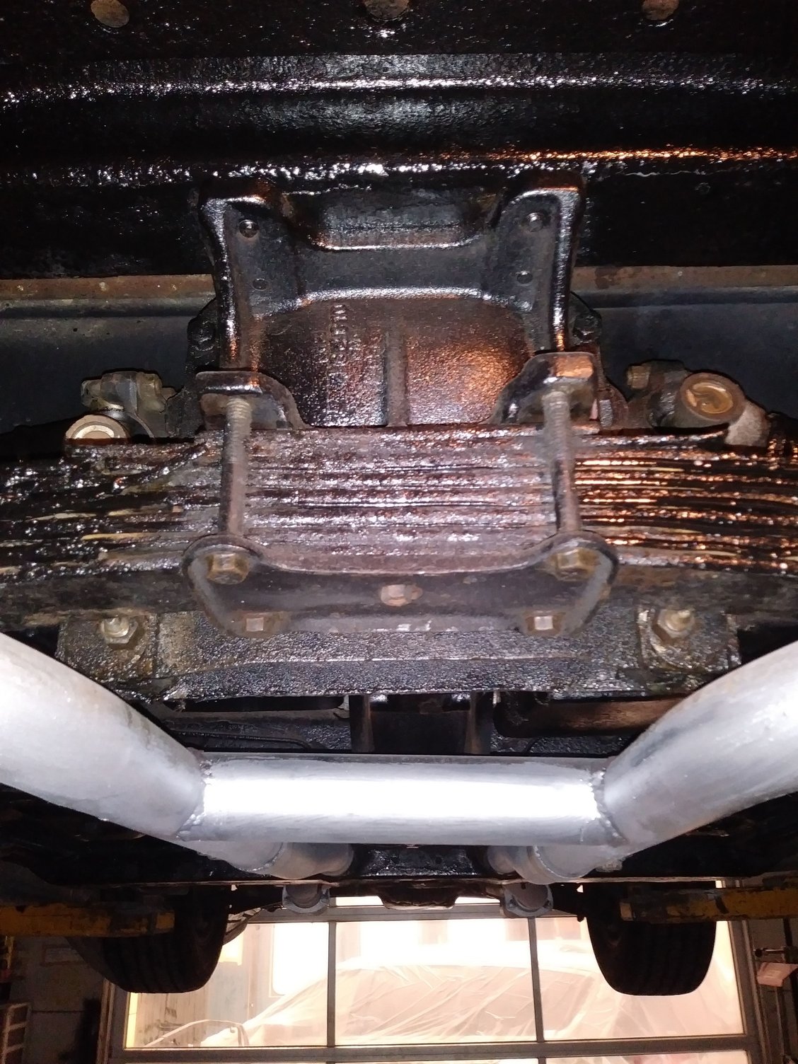

Ok I see the bracket on the bottom....Is there a smaller bracket like the bottom one on top ? Of course the bolts are smaller than the stock ones ......
Present set up..

Now that I look at the photo I see the spacer...Maybe I will call van steel and see if they will sell me a spacer...I don't think VBP is still in business.....My car is at a friends house who will do the work....Rather have a spacer available before he starts taking down the stock spring...

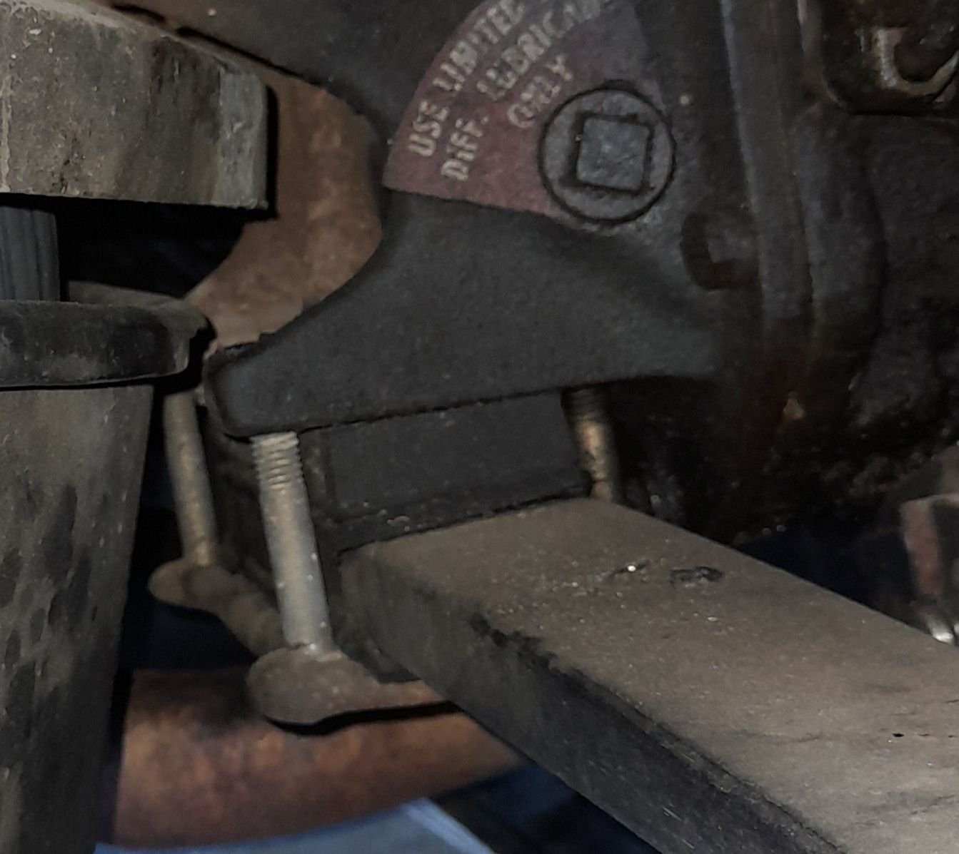

went out and had a look. put it on back in the mid 90's. hard to see with spare tire in the way. but got a "end" view photo.
yup! definitely a spacer in there!
