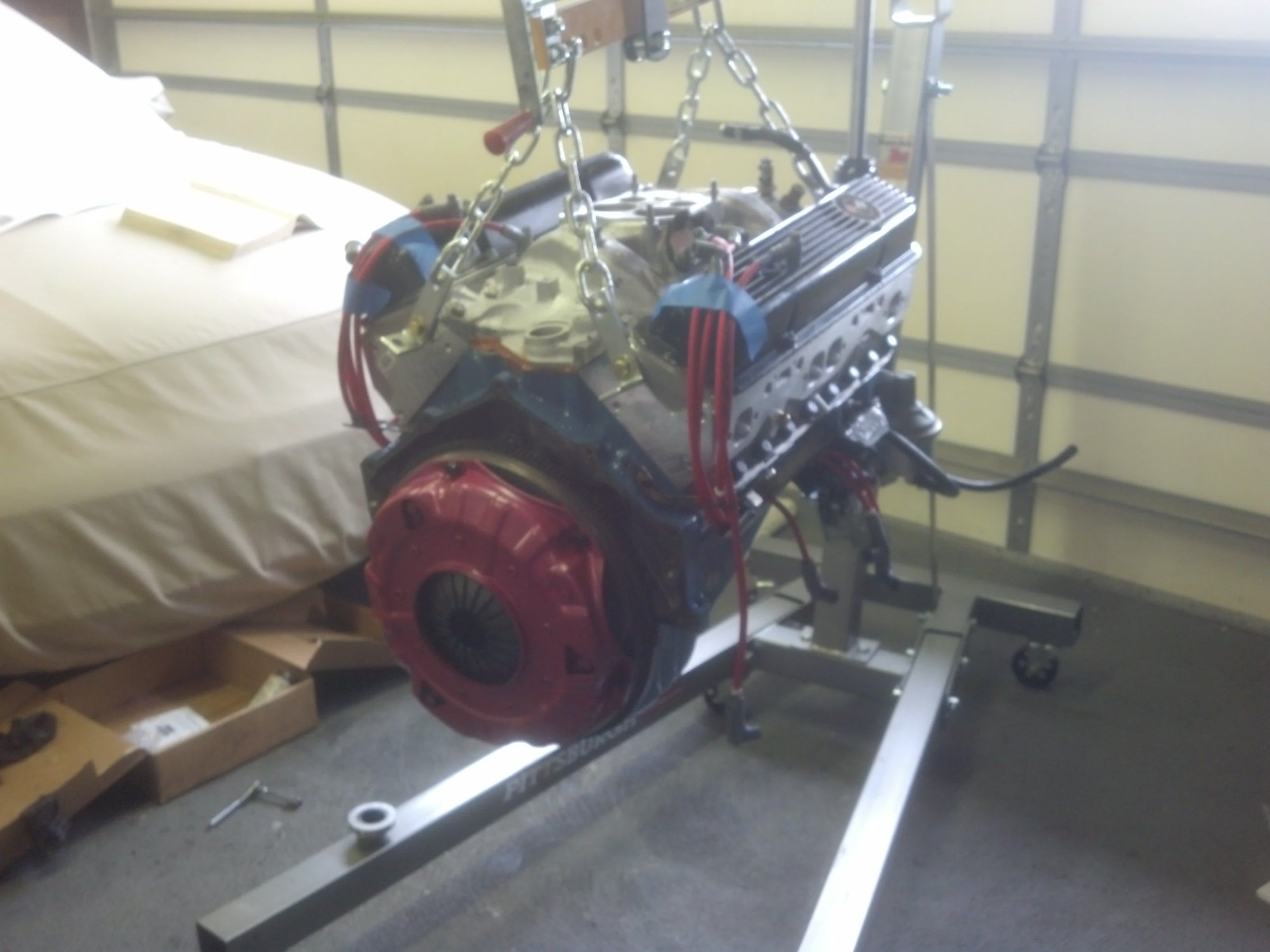

This below...my OEM 78 L-82 rebuilt/upgraded to 425+ Gross HP in 2014...Pretty much looks like an L-82, idles better than a stock L-82 and goes like stink with BIG Mid Range Torque. You have everything in your motor to make top street usable power and torque (I would not stroke an OEM L-82 350), using the L-82 components, and you can make it look like a stock L-82. I did this exact transformation!
I bored my engine (I had to .030). Reconditioned and reused the L-82 forged crank/rods. Ported the aluminum L-82 aluminum intake. OEM L-82 valve covers. L-82 dual snorkel cold air intake system. Painted chevy blue (1978 color).
I did not paint the AFR heads but if I did you would be hard pressed to think it was not stock. Even now most people do not know that the engine has about 150 more Net HP than an OEM L-82.
Howards Roller cam (.525/.525 lift, duration 219/225, LSA110, operating range 1,500-5,600 RPM). I rarely rev the motor to 6,000 RPM and it has BIG TQ for a SBC Gen 1, a match to just about any SBC V8 displacement, sub 400 CI. My 10C6Z06 427 LS7 7.0 liter has BIGGER TQ but for a C3, the motor has very streetable power. This engine also has 1 7/8 inch LTH and is more than a handful for the C3 chassis and suspension for the street. The L-82 355 runs on 89 octane with 10.2:1 compression mostly due to the cam and AFR aluminum heads.
Only 2 minor changes I would make now is slightly more compression to 10.5:1 (not a big deal at all though at 10.2:1, currently, and, a roller cam with .550 or .560 lift to maximize the full flow potential of the AFR heads, at the same duration (don't go too high duration for a street motor, for max mid range power). For a street motor, the lower duration of 219/225 was prefect for max torque between 2,500-4,500 RPM which is where the engine lives 99% of the time...it came out almost perfect, for me!
