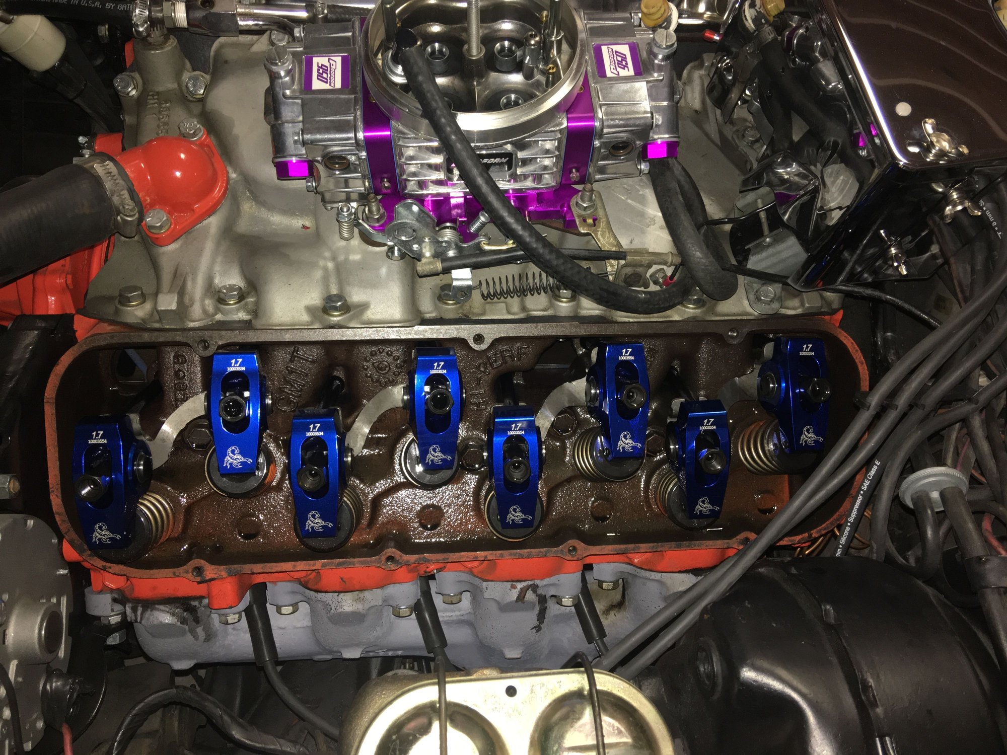

Honestly I would just buy a 496 rotating assembly and be done, and it doesn’t even have to be forged.
I have built them both ways forged versus cast, and never had a problem or failure. A 2 bolt 454 works fine and you don’t even need a roller cam, and it will still make gobs of power.
69 Corvette 3speed auto, .070 over 41/4” crank 3.08 gears Hydraulic roller mid 230s intake, Mid 240s exhaust at .050 GM 990 heads, stock exhaust ported just where the manifold meets the head, aluminum LS-6 intake, HP 950 CFM carb. Working factory air, ps, pb, all factory looking under the hood
Scorpion roller rockers clear stock valve covers
If you want to save even more money, .060 over 454, cast crank, Kieth Black hyper pistons, stock rods with good bolts, Edelbrock rectangle port heads, hydraulic roller in the 240 intake-250 exhaust at .050. This was going in a 67 Camaro that instead went into a circle track car that I beat the **** out of for 2-1/2 seasons 6500 rpm plus for hundreds of laps, and it just got pulled for its intended purpose, still running perfectly, and looks brand new inside. It also has stock exhaust and a HP
950 carb 273 rear gears
67 Camaro convertible.030 over 4-1/4 stroke (makes it a 489) 230-240 @ .050 hydraulic roller, Edelbrock oval port, power everything, 3 speed auto, 3.08 gears stock exhaust manifolds, has Jebby’s favorite carb- the avenger, and still pulls hard to 5800-6000 All of these examples rev instantly, and will shred rear tires until you ar tired of holding your foot on the gas
Edit: the hoaky fuel filter on the vette was temporary until the correct metal one was obtained, also notice I was able to get a carb spacer on the carb of the Vette to get the air cleaner lid higher off the carb, and still cleared the BB hood. I also run the largest mechanical fuel pumps they make without having to use a pressure regulator. I think they are 140 GPH and the 160 requires a regulator which I don't like. I have not had a problem using the 140 even on the race car (circle track) but the race car was right on the ragged edge of fuel starvation.
Also had a small cap electronic tach drive distributor hidden under the ignition shielding.
