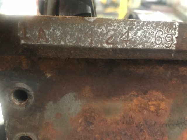

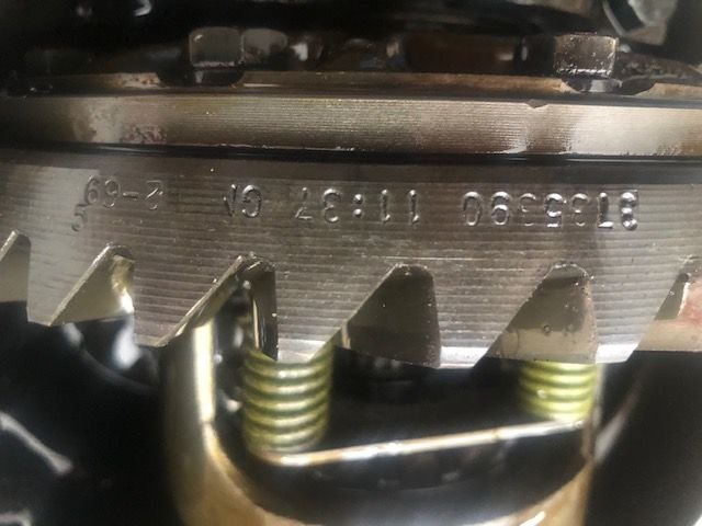

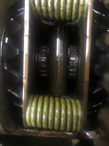

I just opened up the differential, and here are the pictures with codes and numbers. My quick decoding is this is a 336......which would be too good to be true. Still researching. What do you say?
Was surprised how good it looked inside comparted to the completely rusty outside......!
