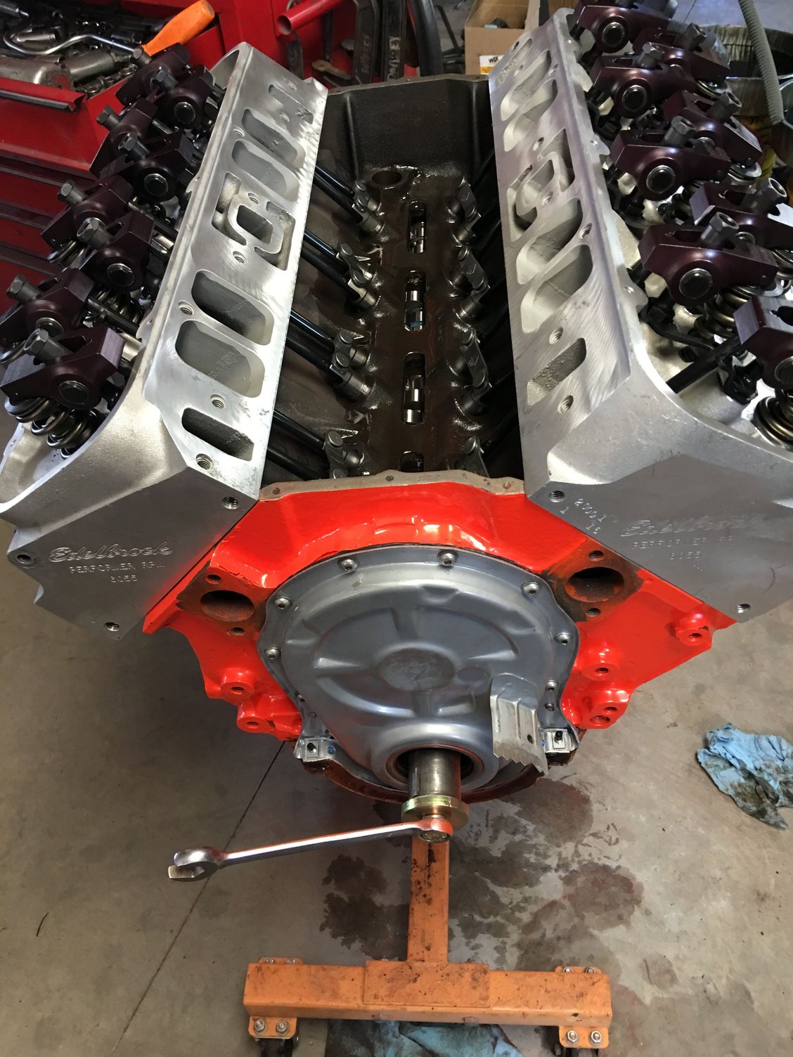

I have an unmolested '67 L36, and a tired '72 LS5. The '72's engine was rebuilt this summer. I wanted much the same as you are seeking: stock looking (started with all dated original components that I did not want to lose from the car); good driveability; strong on the street but not lopey; no need for high rpm (I chicken out at 4000-4500 rpm and no longer feel the need to prove my testosterone) But, I also wanted to maximize performance on the internals, you know, walk softly with a bigger stick? The question is how big of a stick do you need, want, and can afford?
My engine was completely gone over by a one-man shop who builds higher-end engines (~$10k-$15k+) for drag cars, circle dirt cars, and street cars. I followed his recommendations given my input above. We bumped the pistons to get a 9.5:1 ratio, bored .030 over the existing factory bore, did new bronze valve guides, all new valve train, bearings, etc. He polished and balanced my factory crank, rods and new pistons, and put in a mild flat tappet cam (very close to factory grind). In all, it is really just a stock rebuild except for the minor CR increase . On the dyno it came in at right around equal 400hp - 400 ftlb torque - places it right at the '70/'71 454 performance. There's nothing shabby about that for a street driven car and I'm happy that it'll be fun to drive, have a good burble-idle at stoplights, and pull away strongly. Total cost was ~$6000 with no block/heads/intake purchases.
454? 427? I don't think it matters all that much as they look almost identical from the outside and all of the stock intake and exhaust manifolds bolt to either. You mentioned an LS7 block and components for $1500? Jump on that. You may not use the pistons (CR?) but hopefully the crank and rods are not bent or so race-specialized as to require race components or have a shorter life than street parts. Passing a crack and machining inspection is mandatory. With the heads that you install, make sure they have all of the proper bracket holes to mount whatever engine driven accessories your car may have.

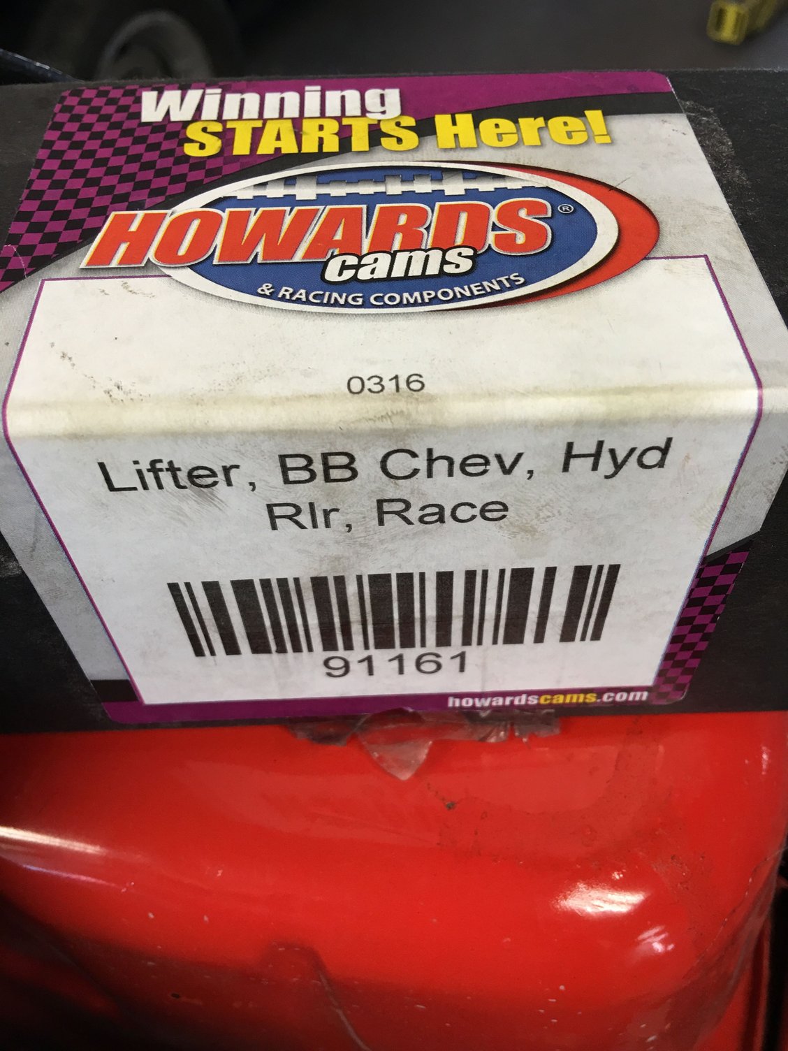

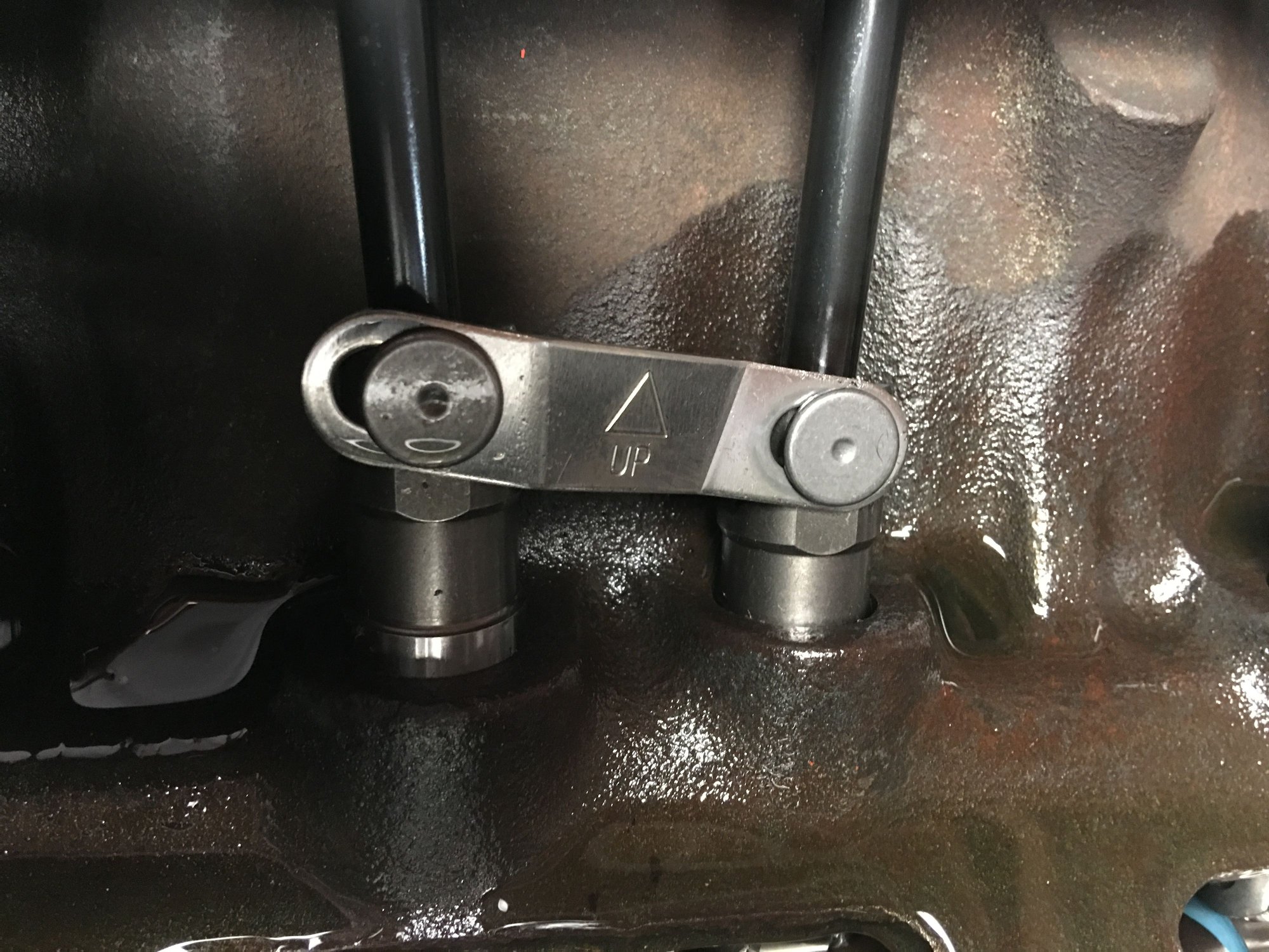

If you do go roller I recommend the Howards max effort hydraulic that are lighter because they are super quiet. I have used practically every brand, and these are by far the best IMO.
Here are the lifters I like if you do go roller.

Thanks man,.....this is the good kind of information I was looking for.

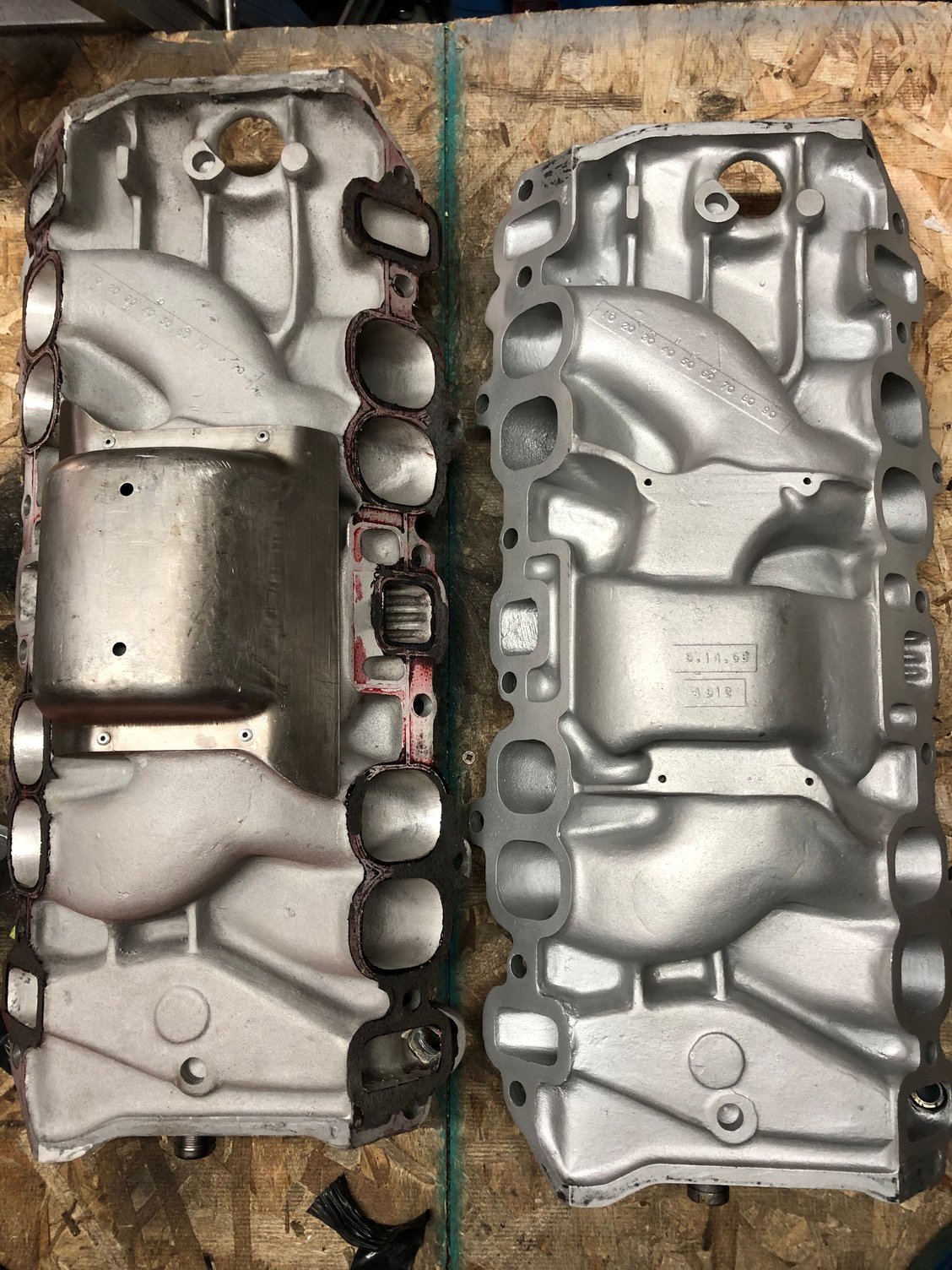

Since we are on a 427/454 build topic. I need some insight on what the manifold on the left is from.(both are aluminum)
thanks!
No casting numbers or brand stamp manifold on left. Original 801 427 intake on right.
oval ports are much bigger on the unmarked intake on left. Is this from a 454?
thanks!
I'm not sure but I think they made a marine version. ???

Look identical other than the finish
The one on the left has had some porting done to it.

I looked and they did make a Marine one but it was Rec port.
