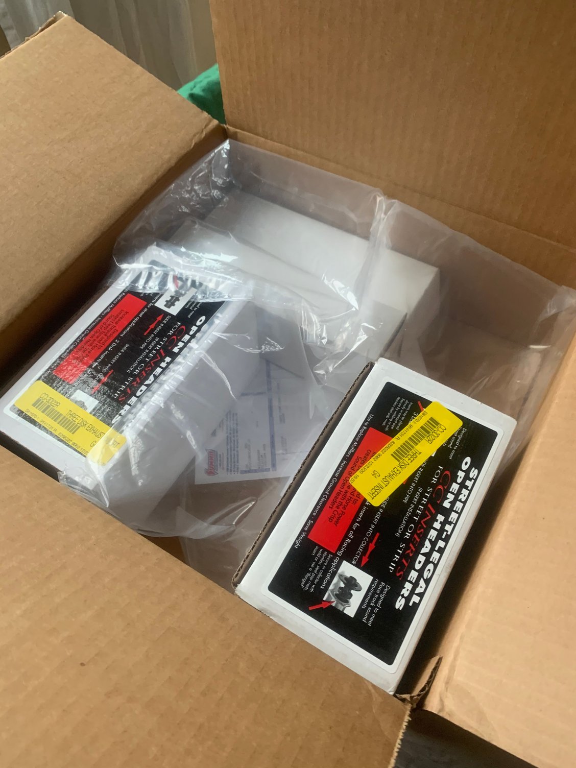

Wow... that was fast. The exhaust inserts and hangers came in quite quickly. Good ol’ Summit Racing.
Reading the instructions on and in box, it seems that if you are just running pipes, the insert should be placed after the collector.
If you’re running muffs, you can put them in the tail pipes.
These inserts do not look very sophisticated.
The fit is super tight, I think mainly because my tailpipes are slightly ovalled-out. The instructions say to grind off a few thousandths, but there not very much meat on the discs.
I think another option would be to simply pound them in, understanding that they will never be coming back out.
I think I’m ok with that, because if this fails, I think the next step is to swap out my mufflers with known quieter ones.

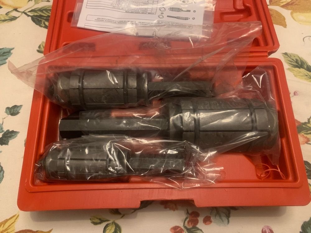

Hmm. Found this on sale. Maybe pounding it in won’t be necessary.
The tool was cheap and could easily break. On the other hand, only a very slight expansion is needed.

I bought this too
Fail.
The cheap tool was not able to put (remove) a dent from the Flowmaster tail pipes. This Flowmasters are pretty heavy duty.
I’m not in the mood to start putzing around to put these inserts into the exhaust pipes behind collectors.
I think I’m now at considering just the cross-over, getting new quieter muffs or a whole new exhaust.

I bought this too
Fail.
these work.. BUT you need to hit it with an VERY good IMPACT wrench..

Instructions said emphatically not to use an impact. Even without it, the tool broke.
I’m kinda ok with it because, having looked at the inserts... they look too restrictive to my taste.
my taiwan one i got was impact stated.. betting yours is china..

I once used a SnapOn tool to expand a pipe. It did it no sweat. My guess is that it’s definitely Chinese.
