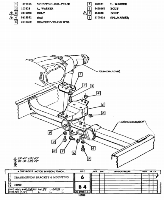

in the third video you can see a bolt with a bit of orange on the tip. Those need to be tight as well, you should checlk all of them obviously
Old Dec 14, 2020 | 09:49 PM
carriljc's Avatar
carriljc
Joined: Jan 2001
Posts: 6,722
Likes: 1,377
It looks like the 2 bolts that come down vertically through the crossmember are loose. It wouldn't wobble like that otherwise.... unless it's cracked? Below is an image for a 68 but should be about the same:

The side bolts aren't even finger tight. I think it is unlikely that vibration shook them loose. My guess is that I simply forgot to tighten them.
I suspect that tightening them will improve things, but not solve my problem
I ordered a low profile, polyurethane trans mount. The idea is to move the T5 away from the trans tunnel and shifter console to avoid conducting normal engine vibration throughout the cabin. Presumably the polyurethane will more positively locate the T5.
So stay tuned...

The way that it is moving in your videos - you'd better tighten the vertical bolts also. Those the ones that would prevent the "tilting".
