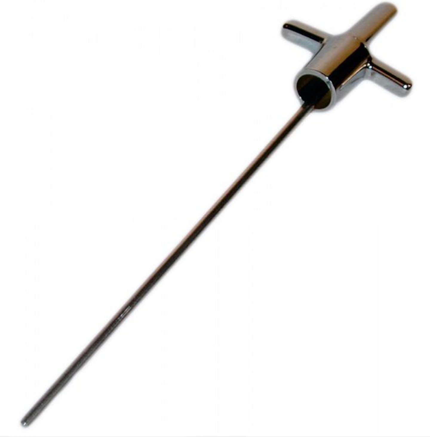

the T handle has a long thin rod that drops way down and keeps shifter from going into reverse. perhaps a burr on the end of the rod? perhaps the slot it rides in is pinched shut near the top or filled with crud and or corrosion?
should slide straight up and out.

Shouldn't have to apply anything. Give it a good yank. I'll take mine off Wednesday and show you what it looks like on the other end. I work nights and Wednesday night is my first day off for the week.
Edit - Found a nice picture. See, nothing to it.
