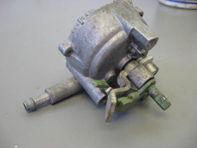

No. A Q-Jet fast idle cam will not drop down when the throttle is opened unless the choke has opened. You can delay the opening rate by setting it to a richer position, but the Q-Jet linkage is completely different, and does not have the Edelbrock problem. If your Q-Jet has that problem, your linkage is assembled incorrectly.
Note that the Q-Jet fast idle cam is hard-supported by the choke lever arm (green part) - the fast idle cam cannot drop down until the choke coil rotates the lever and allows the carb to come down off fast idle - doesn't matter if you tap the gas pedal or not. Edelbrock choke linkage bears no resemblance to this design:
