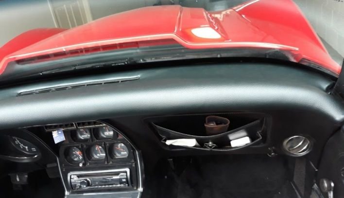

My dash speakers hadn't been used in years. put them in the kick panels with updated stereo years ago. when my dash pad started cracking out at the perforated holes. re-skined the dash pad with a thin layer of foam and then a thin grained vinyl.
maybe not factory, but no more cracks. and kick panels come perforated from factory .

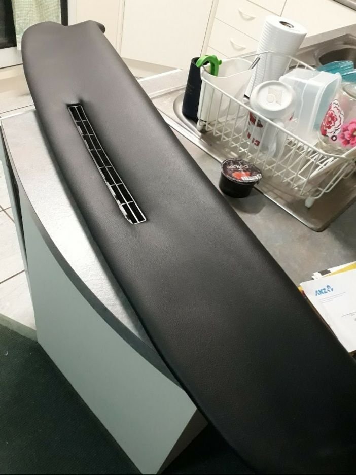

Mine was also cracked at the speaker holes and I recovered it years ago with one of those "skins" that glued to the original and you had to re-cut the 8752 (approx) holes with a little cutting tool and a demel... Looks like they are new versions available bu are considerable more expensive than a set of speaker grills if you can find something that's thin enough to be reshaped to match the dash

I don't think the 68-69 had the speaker grill holes at all and then I think they are all the same from 70 to 76
M
Old Dec 28, 2020 | 10:06 PM
Mooser's Avatar
Mooser
Joined: Apr 2011
Posts: 11,183
Likes: 3,334
For the OP
M
Old Dec 28, 2020 | 10:41 PM
Richard Daugird's Avatar
Richard Daugird
Joined: Dec 2015
Posts: 3,181
Likes: 732
From: Texas City, TX Texas
Wow you did a great job on that! How many hours did you put into sanding/shaping?
Old Dec 29, 2020 | 10:29 AM
Mooser's Avatar
Mooser
Joined: Apr 2011
Posts: 11,183
Likes: 3,334
That's not mine, (I installed a skin) just something I stumbled across on youtube
M
Old Dec 30, 2020 | 12:34 AM
Franks73's Avatar
Franks73
Joined: Jul 2013
Posts: 366
Likes: 19
Guy did a beautiful on that dash pad! Still hoping to find a speaker grill that I could apply on top. Seems strange none came with the speakers I bought. Guess they thought not needed because of the factory perforations in the dash. Thanks for sharing!
