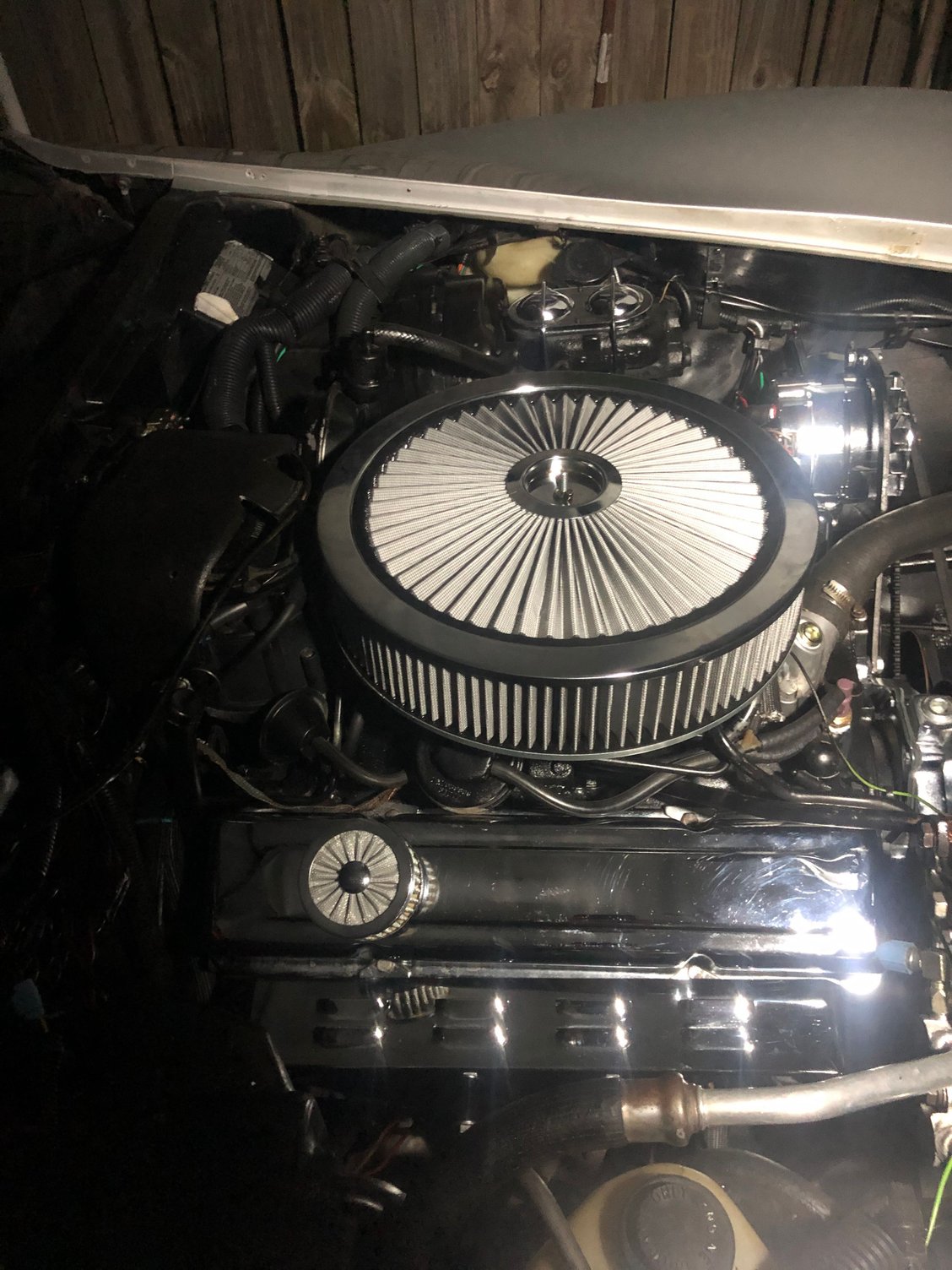

by the way check out the last of the upgrades. that air cleaner started to deteriorate in about 2 weeks. gorgeous but garbage so i replaced with this
Edelbrock 1221 Signature Series Air Cleaner

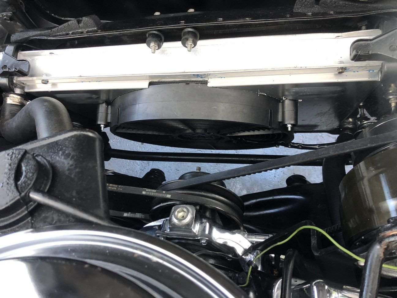

Can you pan back and take a wider photo? Do you have the foam pieces installed around your radiator? Your car would have come with a dual-snorkel intake over the radiator. You'll need to fill that gap, too, to force air through the radiator (if that's the problem).

semi old pic but gives an idea of how rad is mounted

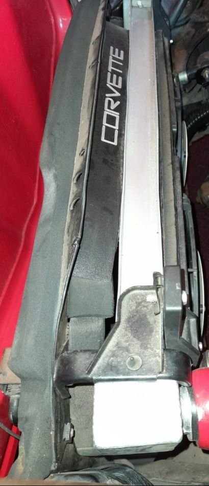

in your photo I can see you still have the factory upper Rad seal, which is cut out in the center for the air intake duct. which you no longer have. although I really don't think this is the main problem. (Really does sound like a bad cap). every little bit helps with these old cars. You can get that upper seal for a earlier year car.
photo of my 77
full length seal keeps air from going over the top of the Rad.
To C3 overheating
photo of my 77
i like it. where did you buy it?
