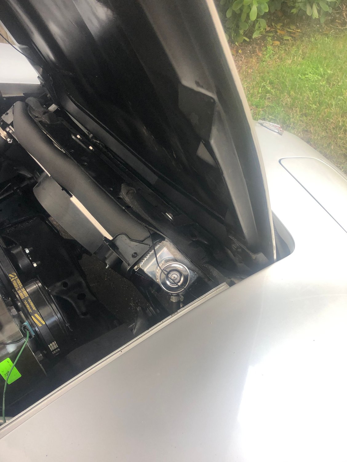

while i wait for the 15psi cap i got the 16psi lever cap. drove it for quite a bit highway and stop lights. got home and the reservoir level was still on the cold level leading me to believe the cap simply isn't opening. i pulled the lever and the tank bubbled a bit and that's it. man i drove it 70mph for awhile and had quite of bit of red lights after. it should have built up heat. the fan is set to 195 on and off at 185 now. anyway, i guess it's just not getting hot enough. shouldn't the water in the reservoir risen to the hot level or somewhere in between?
i also bought some insulation from home depot and used the rubber one on top and a small one on the side to keep air in. also used air condition duct tape to cover the vented holes you were saying.
see pics. will return excess.
