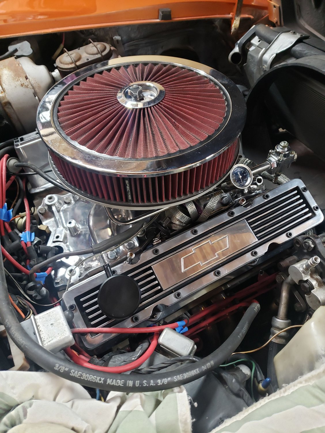

Originally Posted by michael lamoglia
by the way check out the last of the upgrades. that air cleaner started to deteriorate in about 2 weeks. gorgeous but garbage so i replaced with this
Edelbrock 1221 Signature Series Air Cleaner
https://www.amazon.com/gp/product/B0...?ie=UTF8&psc=1
was yours a spectre brand? If so its interesting we would have such opposite experiences as this is a pic of mine today after just over 6 years and 6000 miles on it. Ironically I had the edelbrock one you just bought on the car when I bought it.
I did just purchase a new dual input CAI to replace it as I make other changes which is why my engine is in disarray right now.
when held to the light theres no signs of disintegration on mine.
so on mine the top layer of fabric started to discolor black and developed some holes. it could be related to something else on the carb spitting out something. not sure.
