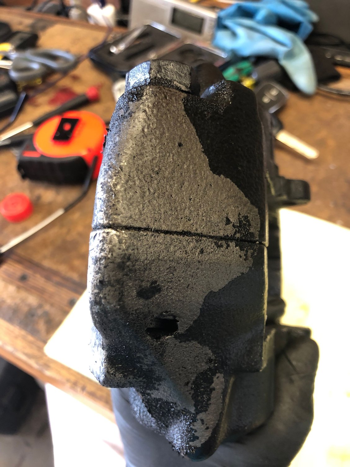

Is this caliper rebuildable?
Old Jan 4, 2021 | 02:52 PM
69L88's Avatar
69L88
Posts: 3,413
Likes: 1,824
From: Apple Valley, MN
Another way to tell is to get a small magnet and check for relative ease of ability to pull the magnet away from the wall of the bore. Stainless is non-magnetic but the thin wall of the stainless sleeve and the large mass of cast iron around it will allow the magnet to “attach”.
I just did “pull” test on one of mine and there is a clear difference between the amount of magnetic attraction between the stainless sleeve (as tested in the middle of the sleeve) and the casting.

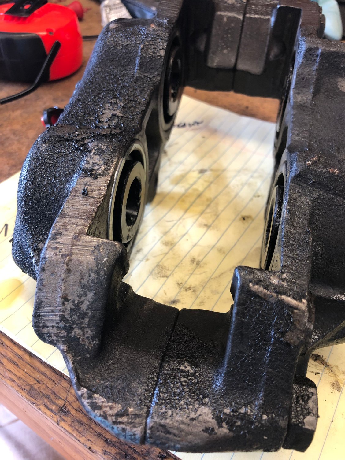

Fast forward a few months. I bought autozone calipers for cheap with their lifetime warranty. Reason I did that was because I could have the caliper available in a short time, without paying massive shipping costs to WA from east coast (especially if caliper leaks).
I'm on my 3rd driver's side caliper, and it leaks AGAIN. Haven't driven the car yet so it's not rotor runout. Other 3 calipers (I think) are fine. Should I try NAPA caliper next? I want something that's reliable so I won't need to touch my brakes for a long time. From reading on the forum seems like good places like Lonestar even leak after a few years. I was considering Eckler's, Zip, Willcox. Called Willcox and they said SS sleeve are not necessary and it was just a marketing scheme, which seems to against all I know about corvette brakes. Also mentioned I don't need Delco casting since it's only for people who want to be judged and no difference in quality. I asked and the Willcox kit I was looking at was not made in US. Wilwood's are a bit outside my budget. I'm probably looking for SS sleeved with O-ring seals.
Any help here/what would people recommend?

Have you pinpointed exactly where the leak is coming from?

The leak is coming from inside the caliper, from one of the pistons on the inner side, not from hose or brake line connection. Brake fluid then collects at lowest point and drops on the floor.

C3 calipers are leaky, they are a poor design. Not sure it matters much on the supplier anymore. I’ve tried all major suppliers over the years. One thing that’s consistent is that they all will leak at some point. Especially if the car sits for any length of time. Best option is it go with aftermarket in my opinion.

Autopsy..not sure..zip said he has seen some where o ring didn’t seal..maybe..and it sprayed..but looks like o ring area and or one side from pistons..
side note..the carbon fiber ceramic pads seem nice
i also find it weird unlike when i rebuild them the springs push out the pistons..these seem static..i would open ot up but warranty

Seems like the springs may have not been installed behind the pistons.

I would be interested in knowing what the Ra or RMS values are of the bores. I’ve seen quite a difference among those I have seen over the years with some exhibiting a “mirror” finish with others that you can feel the irregularities with your fingernail. Take a close look at your leaking bore. If they aren’t smooth, you might be able to address the problem by running a cylinder hone for a few seconds to knock down the irregularities.
You should have 0.0045” to 0.010” gap between the piston and the bore. Get some shimstock and remove the O-ring.
