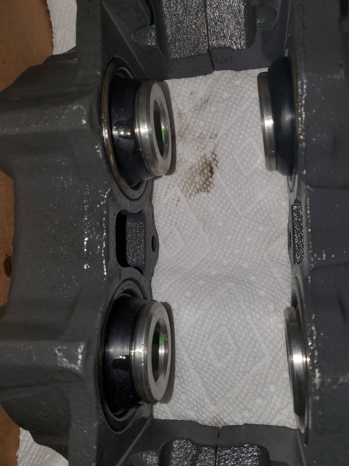

I'd hate to just keep replacing my calipers and bleeding my brakes each time. Hoping to find some higher quality calipers with SS sleeves which I can just rebuild myself in future if something goes bad (instead of shipping to east coast)

You should have 0.0045” to 0.010” gap between the piston and the bore. Get some shimstock and remove the O-ring.
if it wasn’t for the warranty i would rip it apart..i find it strange after replacing pads they really started leaking..
op I didn’t have ss inserts or i would have rebuilt with orings myself..not understanding the shipping..many offer free shipping ..

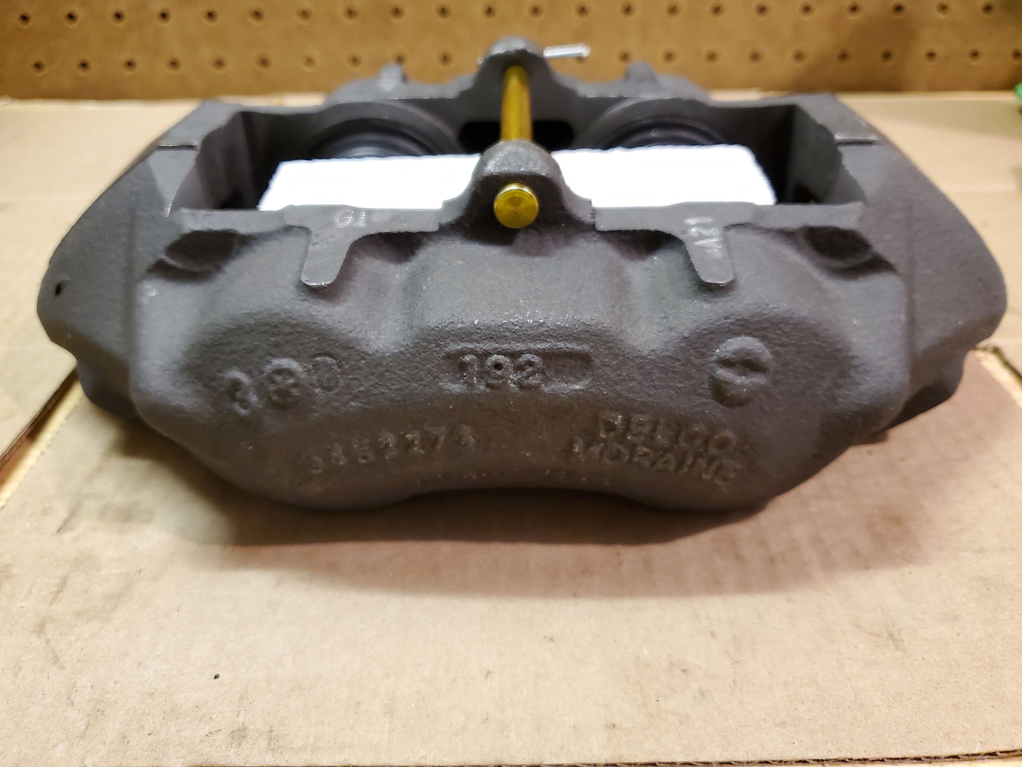

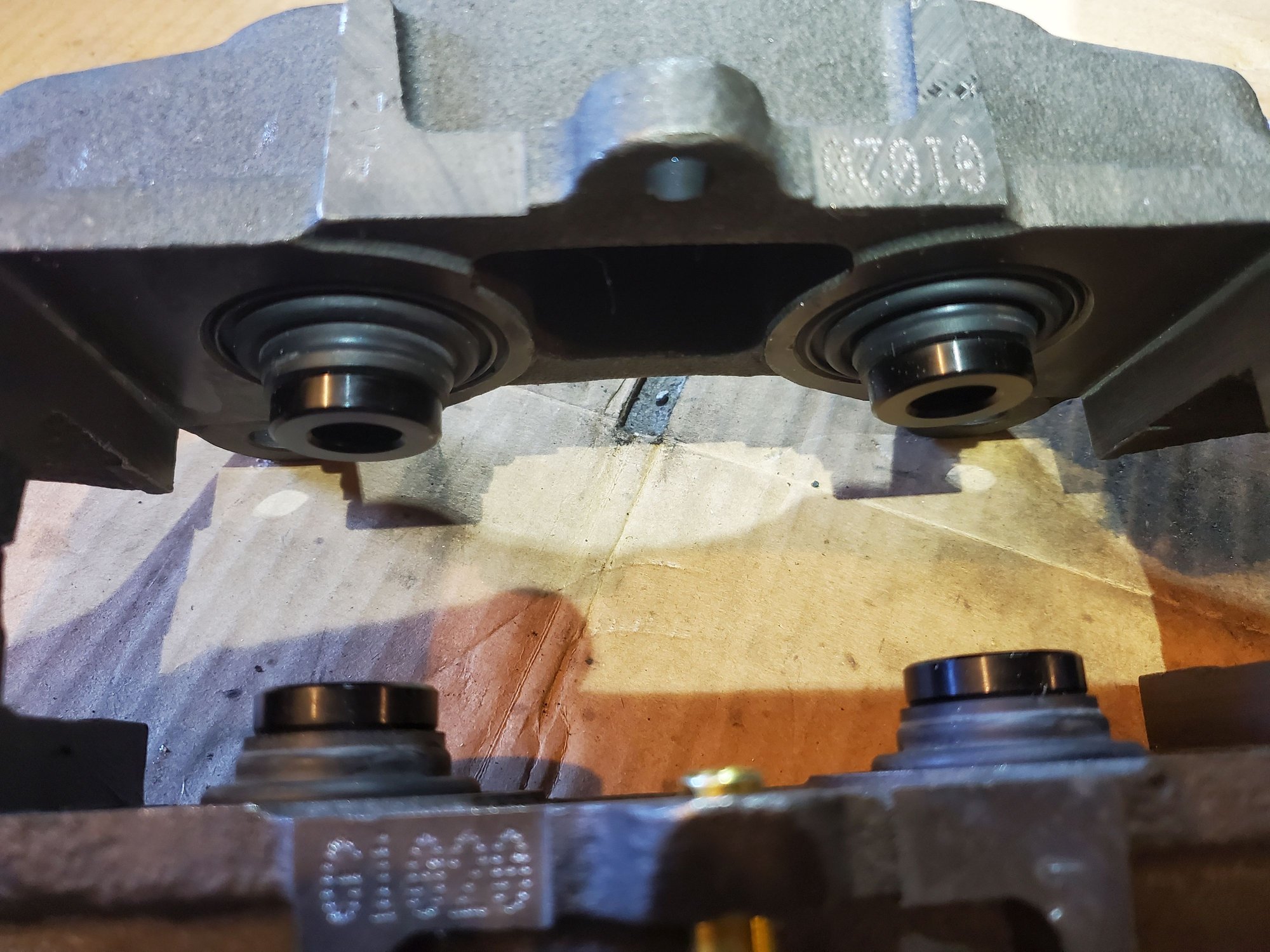

Wanted to update people who may read this thread in the future:
So after struggling with the cheap Autozone calipers (tried 3 different driver's side calipers, bled brakes after each one, all of them leaked), I returned them all, frustrated. I didn't think they would give me 3 different calipers all which leak. On their website they claim "Duralast remanufactured brake calipers are built under the strictest quality standards, in a state-of-the-art facility. Each caliper is extensively tested to ensure it meets or exceeds OEM performance". Don't trust it!!! I wasted A LOT of time. The only positive experience I'd say is the people working at Autozone were very nice and understanding, and I got my money back.
Now for Ecklers: I got the parts on time, within a week of ordering. Instantly they feel higher quality, and even the boot around the pistons has a different design (not that it matters for fluid sealing but something to note). I installed all 4 new casting SS sleeved O-ring calipers a few weeks ago, bled the brakes, and the pedal is now pretty firm. I went for a very short drive (for the first time!) and they felt pretty good (didn't get a chance to bed them in yet). So far, I'd recommend Ecklers. Will post if anything changes, I'm very happy to be done with the brakes, crossing fingers no more brake issues in the near future.
New Delco Moraine castings, SS sleeved with O-rings from Ecklers
New caliper
New caliper
Poor quality Autozone caliper, had 0 miles on it since installing.
