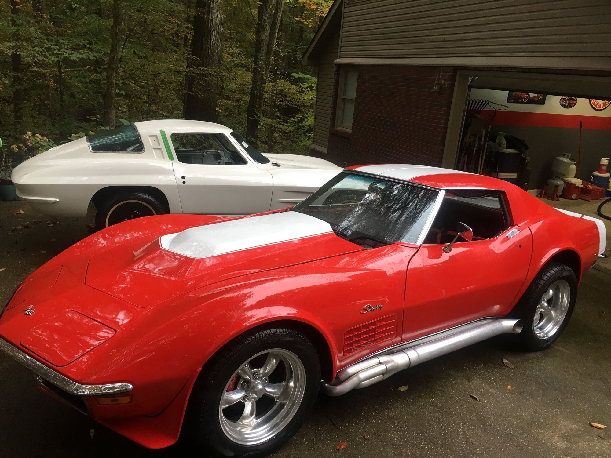

Question for the crew. 1971 Corvette coupe with new modern front headlights... I'm struggling with how to incorporate my fiber optics with the new headlights. I am of the opinion that I can't be the only one out there facing this problem. What is the fix?
Thanks Keith

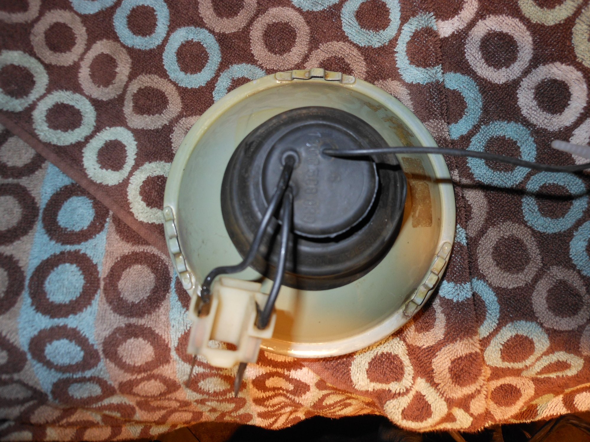

I made it work on a replaceable bulb type--
Bosch High Beam-
Drill hole to fit fiberoptic - IIRC it was 5/16"
Fiberoptic plugs right in
Rubber dust/water shield holds it in place-

With the H1/ H4 style bulbs I drilled a hole in the base plate. Problem is you need to keep it away from the bulb or the FO can melt
