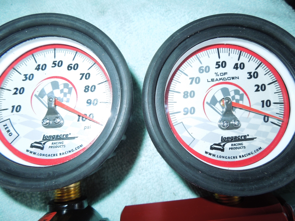

Originally Posted by gkull
With a mild low lift HR cam I have installed solid rollers before. I Had to use standard length push rods and I went from 145 pound seat springs to 200 pound seat springs. Because of the mild lobes on a comp cams extreme series hr 242/248 I was able to use .012 /.014 lash.
Your running hot oil pressure determines the weight of engine oil required. HRollers get noisy with thin oil and low pressure. The oil bleeds off so fast that the lifter never pumps up so the lash opens up.
A leak down tester will show if your HR lifters are over adjusted causing leaky valves. It's really easy to adjust h lifters. Just never put a bind on the push rod when adjusting, your can roll the push rod in your fingers at Zero lash hot

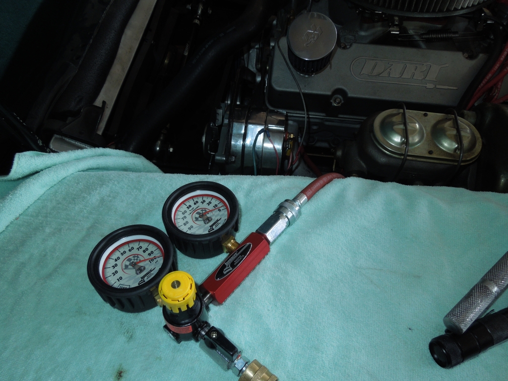

Originally Posted by Danish Shark
Yes, maybe I should just keep the excisting cam or get a better HR cam and use the solid lifters on that.
Not sure what a leak down test of lifters is?
This is doing my 396 ci sbc leak down test. Screw into the spark plug hole. supply a regulated 100 psi and the second gauge shows the percentage of leak. like around the rings or around the valves you would hear air coming out of the intake manifold. This is about 3 percent which is a super healthy new engine. I think it has about 10,000 miles on it so it is amazingly low leak down. for 1.5 mm racing rings and 7500 rpm all the time
Oh right, a cylinder leak test. I got that information twisted in my head and was thinking how do you make a leak test of a hydraulic lifter
I actually bought a leak down tester, but never go around to using it.

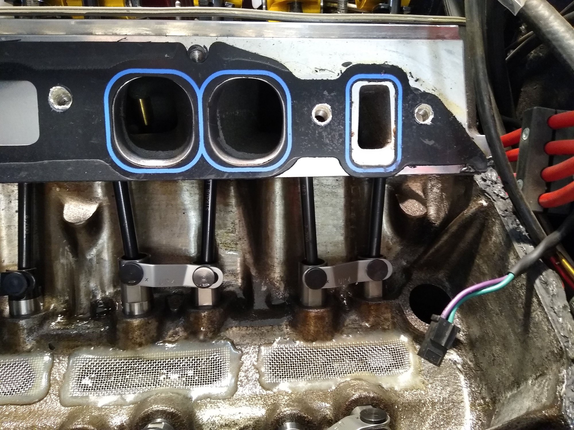

Old Feb 9, 2021 | 06:30 AM
  #39
Danish Shark's Avatar
Danish Shark
Joined: Aug 2008
Posts: 878
Likes: 55
From: Deep South Denmark
Got working on it again after being out of commission for while after getting to close to someone with C19 (I didn't catch it but couldn't leave the house).
Intake gasket looked good and dry, no signs of oil being sucked in and a nice imprint of the intake all arround. I don't believe i've had any issue with vacuum leaks here.
Old Feb 9, 2021 | 07:14 AM
  #40
Jebbysan's Avatar
Jebbysan
Dr. Detroit
Joined: Mar 2012
Posts: 10,093
Likes: 4,019
From: New Braunfels Texas
The lobes on the basecircle look low......do you have better pics of the lifters in their positions?
Jebby
