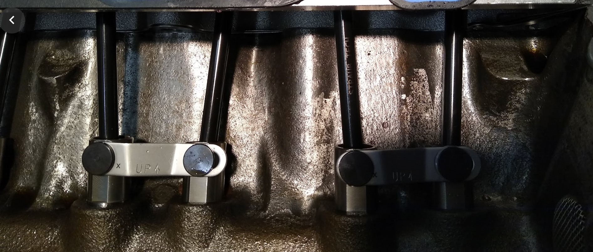

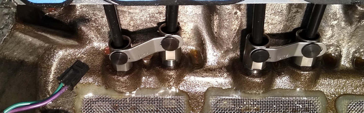

Originally Posted by Jebbysan
The lobes on the basecircle look low......do you have better pics of the lifters in their positions?
Jebby
Cylinders 2 and 4 (Cylinder 4 has the Comp lifter!):
Cylinders 1 and 3:
Cylinders 5 and 7:
