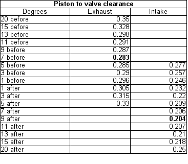

These are my clearances with the current setup:
