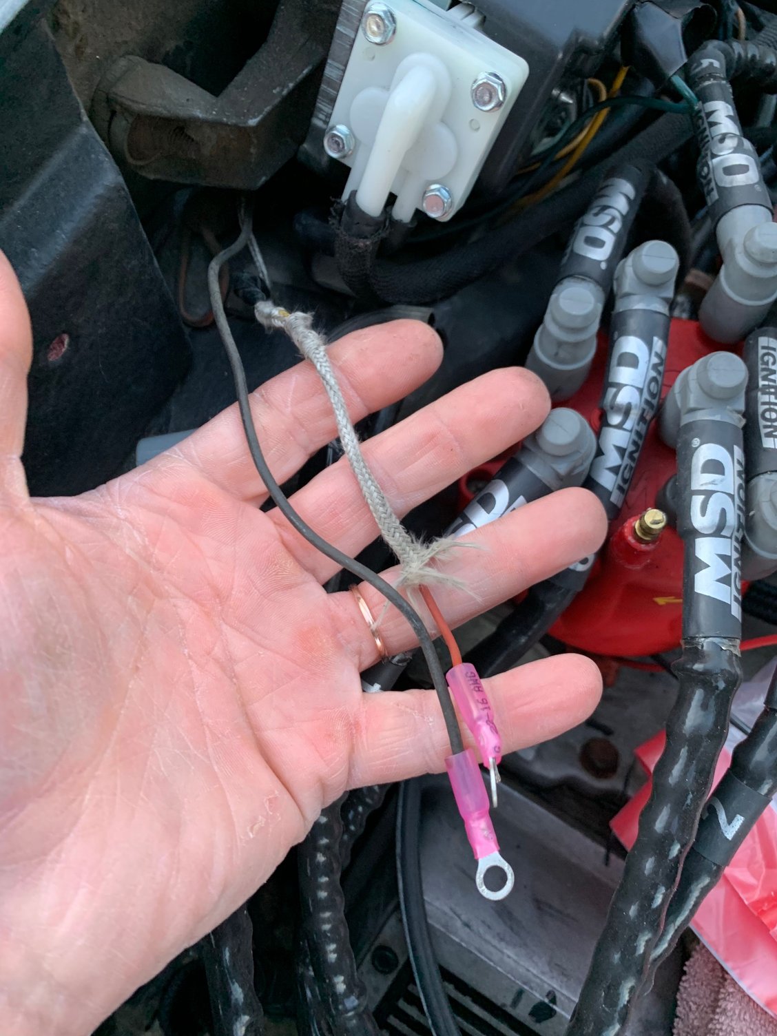

These are the wires coming out of the vehicle

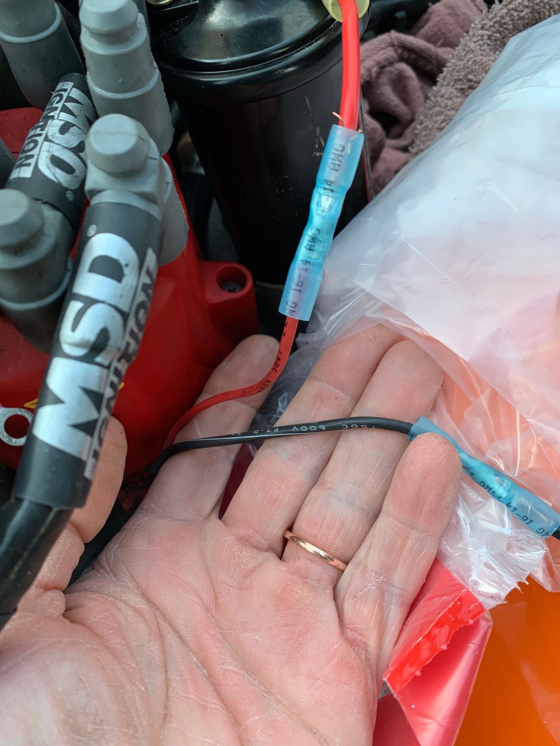

These are the wires from HEI

Not a very good photo of that distributor to be certain. BUT, doesn't look like a HEI to me.
Never heard of a HEI without a coil built in to the top.

hi. Thank you for taking a look. After some research I think I have a Pertronix conversion HEI. They had it linked to the coil positive instead of 12v continuous power from fuse box.
my plan is to connect Pertronix red to ING fuse for continuous power and the black distributor wire to coil neg

Stop confusing people by saying HEI, that is NOT HEI.
You have a Pertronix distributor or a conversion kit.
The red wire from the Petronix should go to the IGN post in the fuse box.
The black wire goes to the negative terminal of the coil.
The original wires coming through the firewall are not used.
Did you buy the correct coil, there is more than one MSD Blaster 2?
